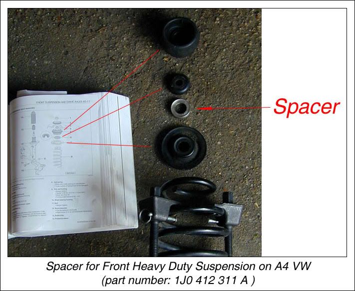

In some diagrams and other who have replaced suspension on the vortex they have an aluminum spacer:
http://forums.vwvortex.com/zerothread?id=2873144
for a pic of what I am talking about.

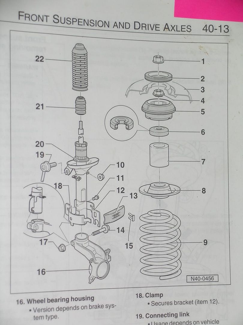

Here's some reference
It's #7 in the Bentley but this is the R32/TT diagram - same for Jetta/GTI just
with a smaller spacer in the pic above. Supposedly this can be removed with no consequence. I am just wondering if I can remove the top of the strut and pull it out if I have in installed - without getting an alignment again.
