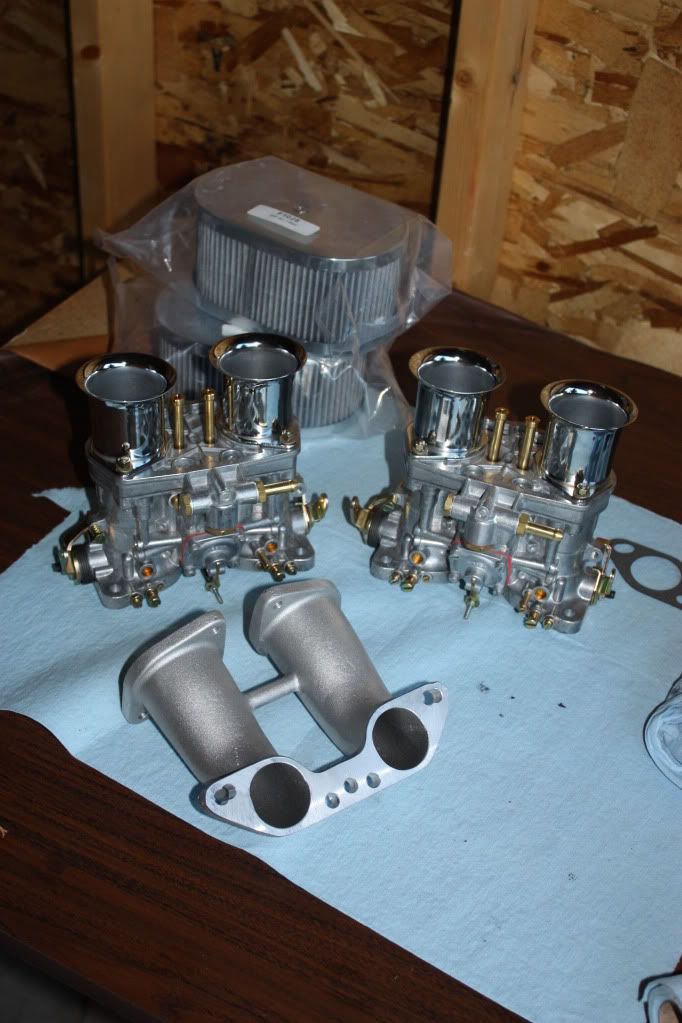

Goodies :mrgreen: gotta drill/tap that intake for power brakes tomorrow.

Are those Weber IDF's? If so those carbs are pretty shitty, have one on the sand rail, 44mm.
Re: 76 westfalia camper
Roadhog wrote:Are those Weber IDF's? If so those carbs are pretty shitty, have one on the sand rail, 44mm.
Anti-Weber? I have had nothing but success with Weber carbs. A good resource is or at least used to be top end performance. I got a rebuild kit and performance jets from them a couple years ago. Everything worked great :)
nope, just anti weber IDF.

I hear there are very sensitive to fuel pressure, alot guys use adjustable FPRs.
Sorry to hear you are anti-weber IDF i have never used them before but i am sure i will get them running top notch..

4est wrote:I hear there are very sensitive to fuel pressure, alot guys use adjustable FPRs.
I had a corrado and it sucked so ALL of them must suck too. Right?
Corrados do suck. :laughing:
It has an adjustable FPR on it, but still has a decent flat spot, and will bog on tight left hand turns. If you get them running well, let me know what you did. The first one was sent back because the casting was defective, and this one has been jetted, and adjusted, still cant seem to get it perfect. Works great at wide open throttle though. :laughing:

3.5-4 psi? that what i hear they like..
