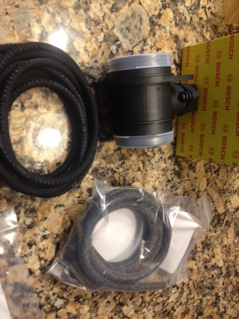

I took a recent trip up to Utah and back and along the way there's several many mile long uphills. I went into limp mode a few times, (key off, key on clears) and read that the 3 most common items could be AFM, vacuum leak or sticking VNT vanes on the turbo.
Starting out with the easy bits I got this in the mail. Oooh nice soft new rubber.

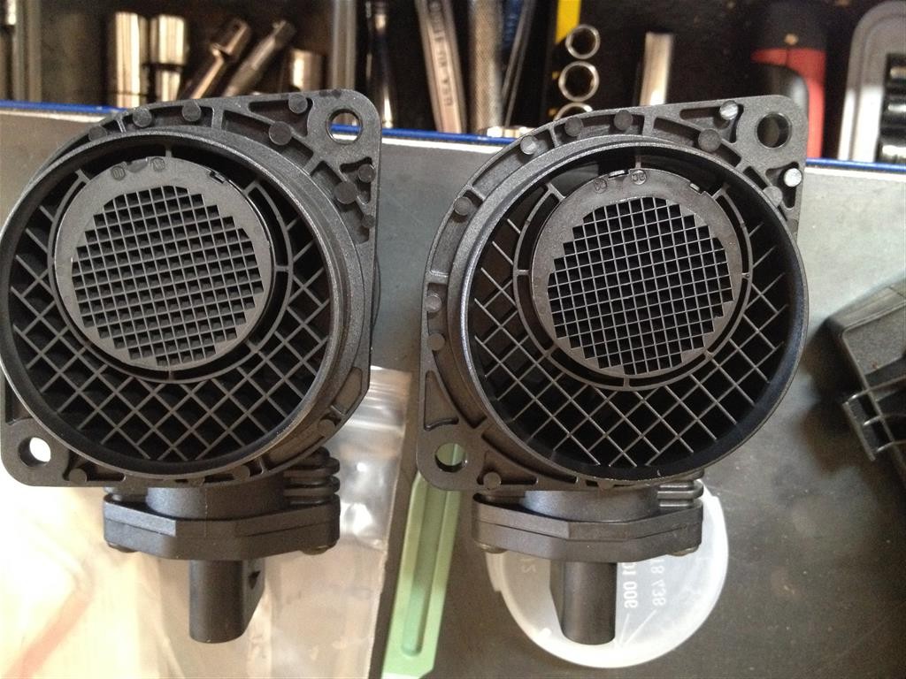

Got the new MAF installed. Also put in a new airfilter since I was there.
Went for a 200 mile drive, and... still does the limp mode thing.
For sale, 1 used MAF, still good, was not the problem :nod:

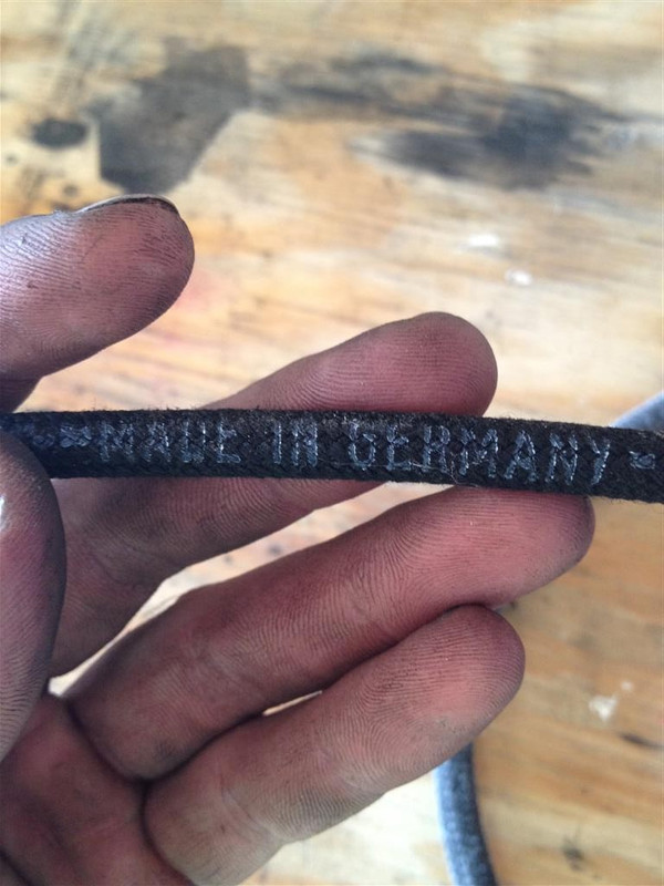

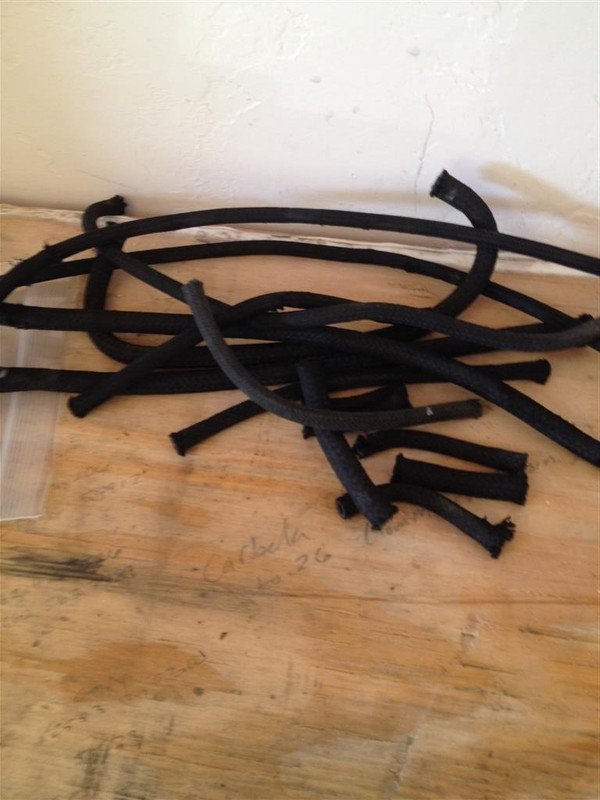

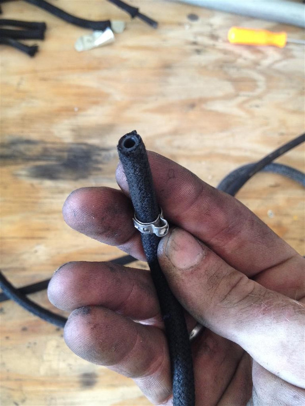

Next I replaced all the vacuum lines. Mmmmm new rubber
Some of the old ones were suspect, cracking and such at the ends
Only one that was a pita was at the turbo. Why this is the only one that gets a clamp I don't know, but it's rather hard to get the clamp to release since it's tucked in the actuator.
Have not gone on a long drive so I don't know if I'm fixed or not.

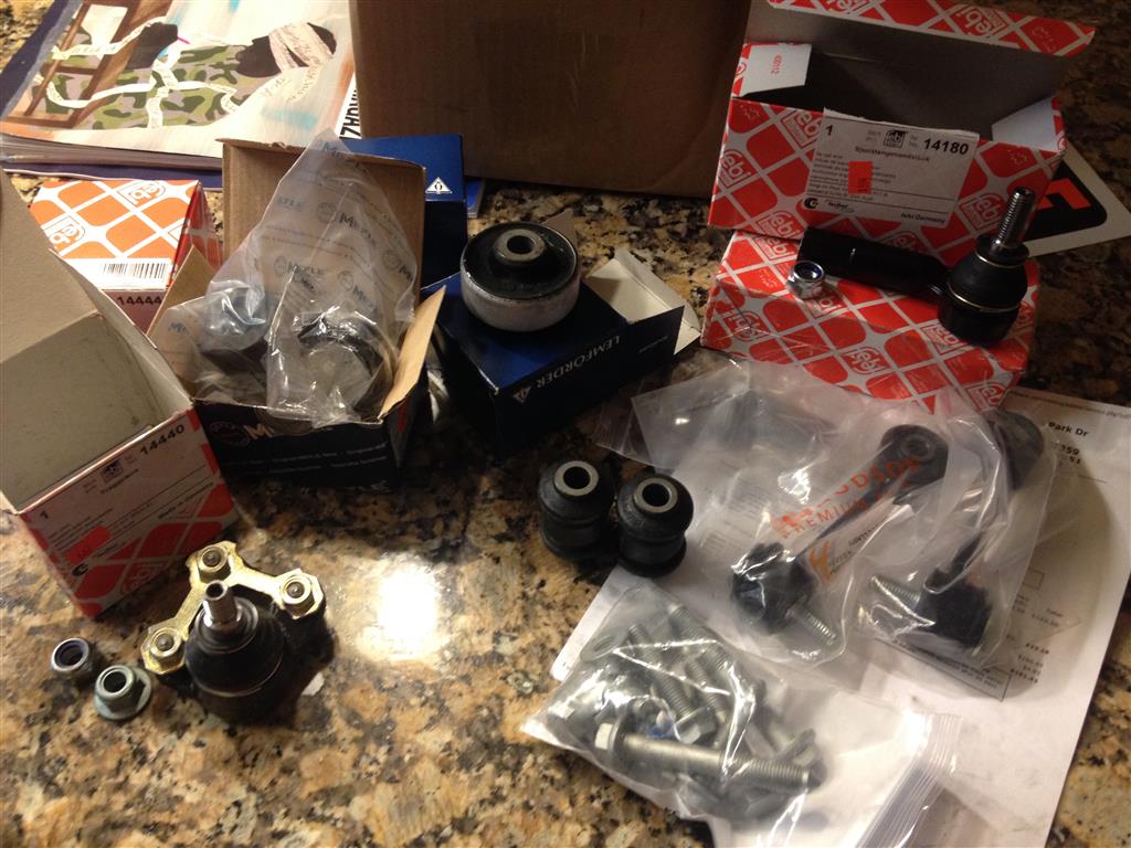

Car is creaking. Ordered a refresh kit from idparts. New bj, tie rod ends, control arm bushings & anti-sway bar bushings and brackets; I went with the Audi TT solid style vs the oem.
Sunday the car will be home so I'll try to get it all in then.

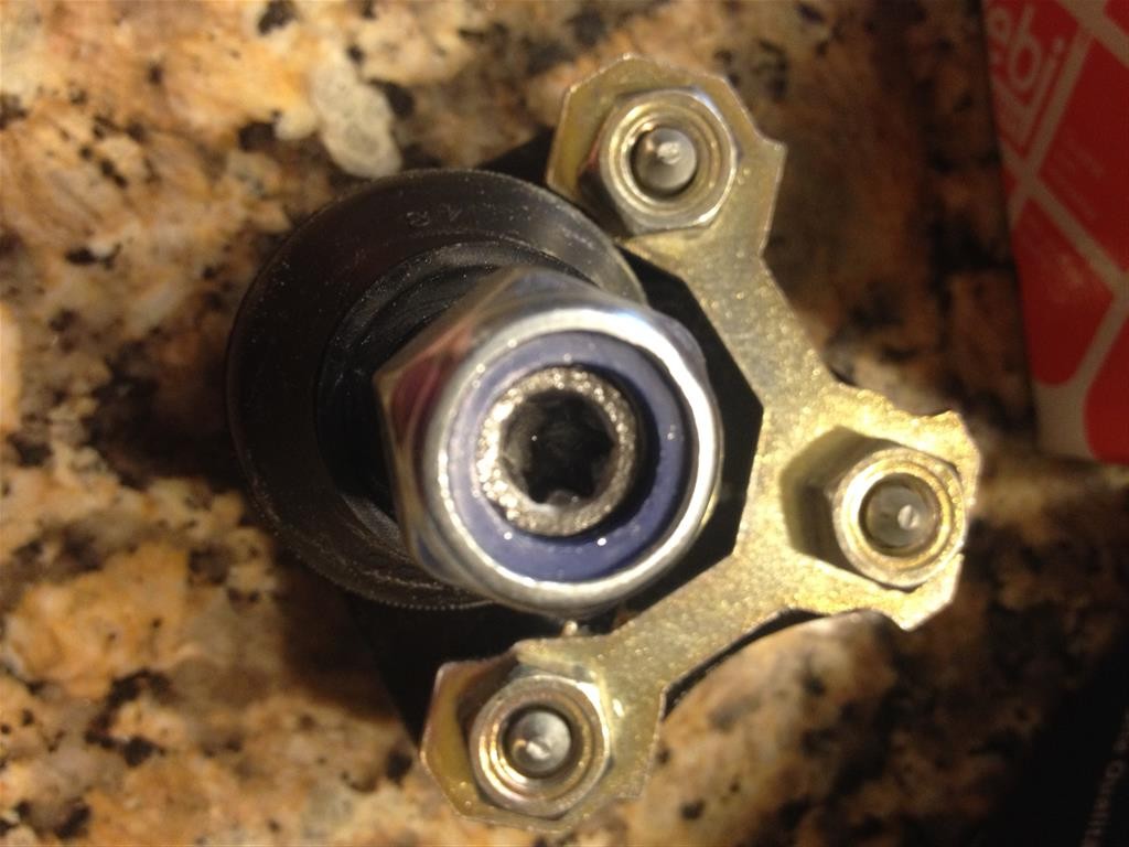

How cool is it that the ball joints have a torqx fitting on the top? heck yeah!
And this pictogram on the box suggests only use when carrying a very large wrench & wearing a bib and ball cap?

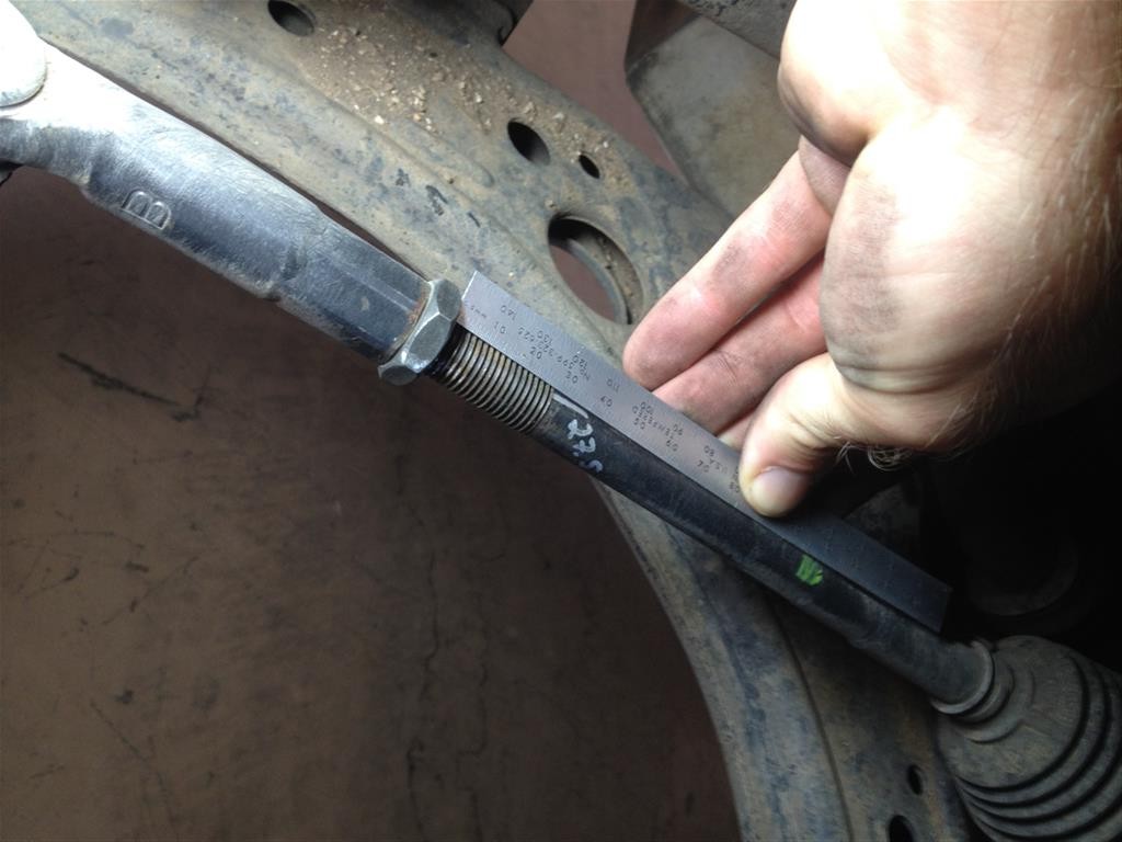

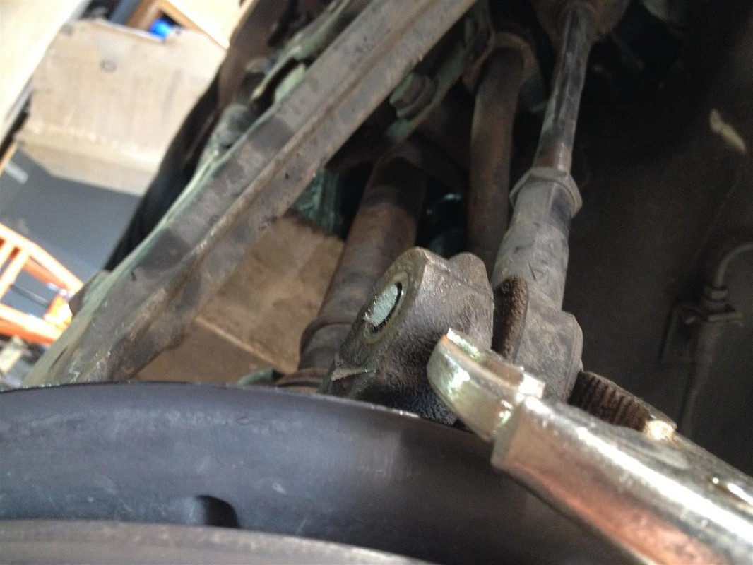

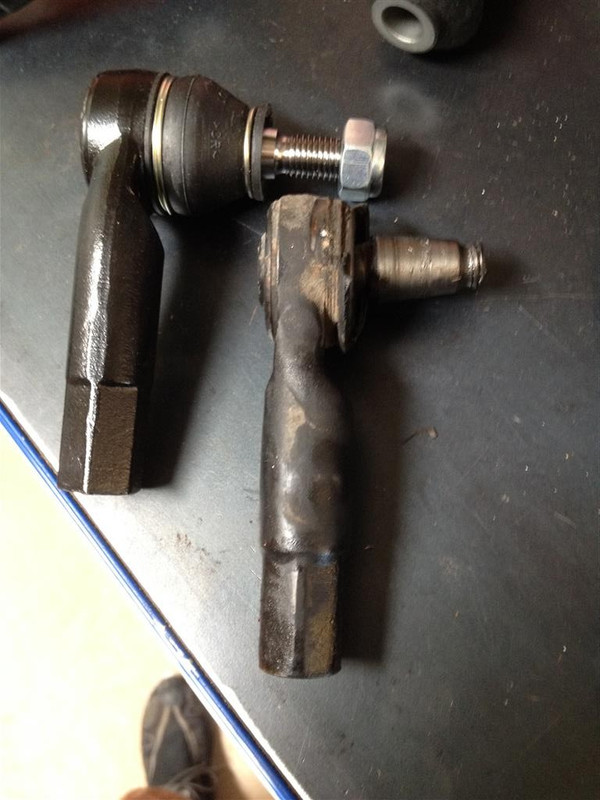

First measured up the threads showing on the tie rods so I could get those back on somewhat close

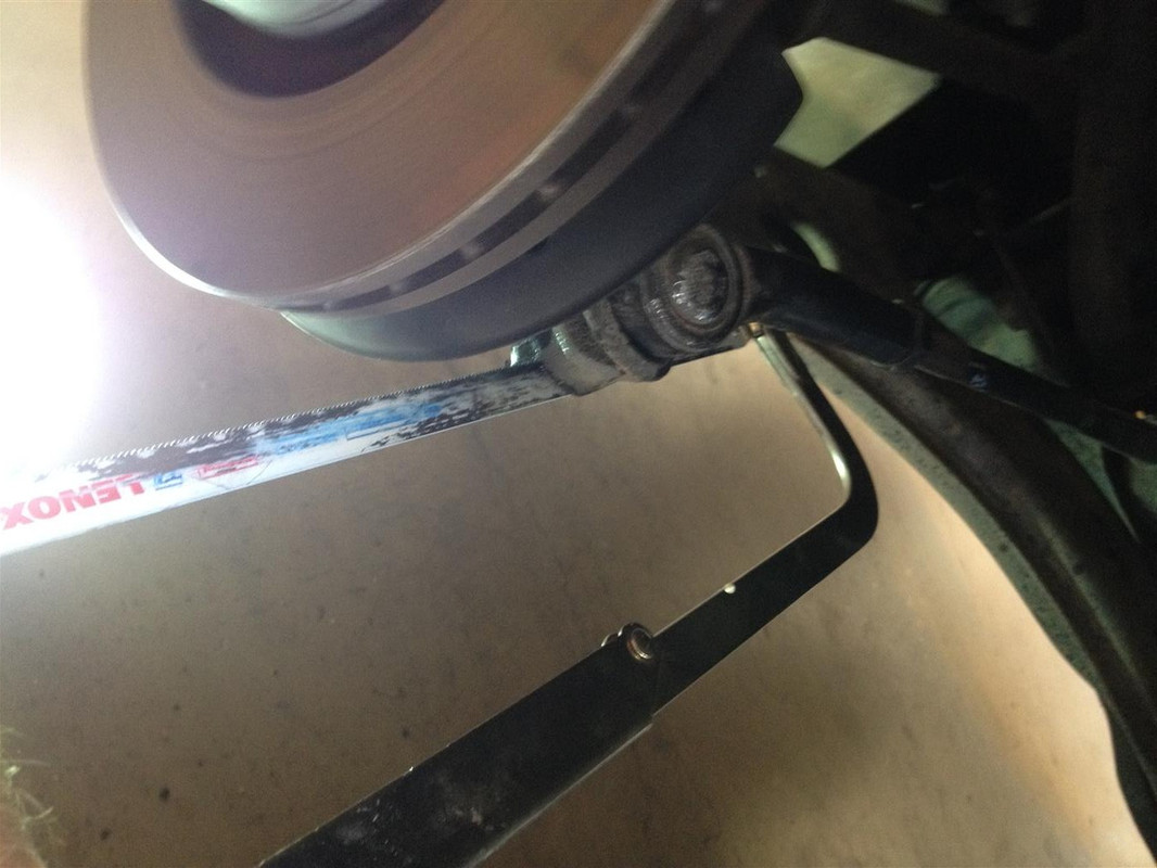

Of course the nut on the tie rod end wouldnt come all the way off, but it did go far enough i could get a hack saw blade in there, so cut them off.
Old vs new

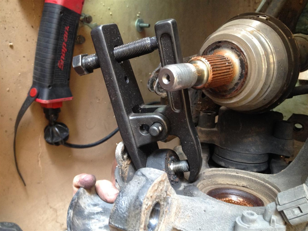

Ball joints came off with no drama at all. This tool from Harbor Freight is the tits for ball joints

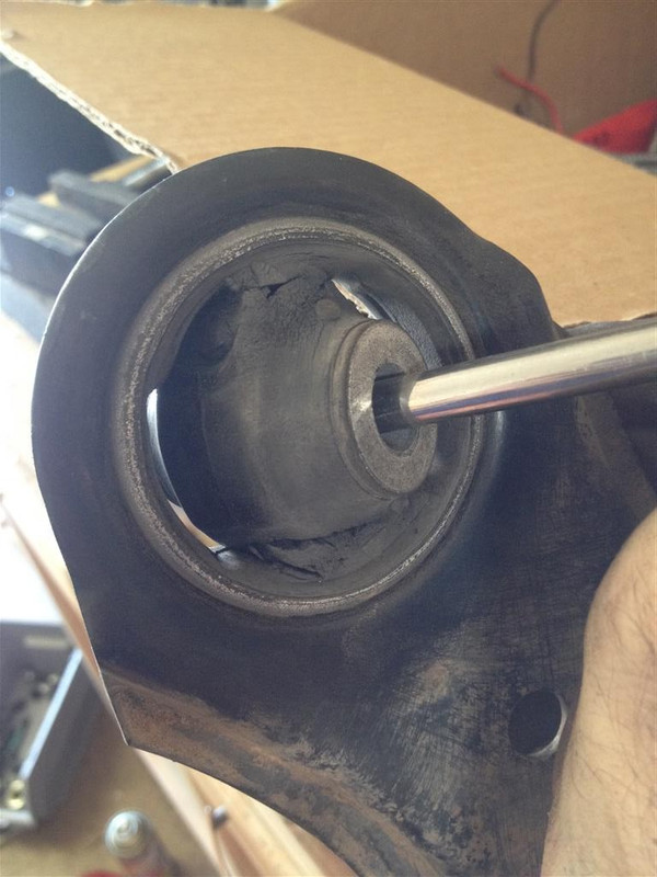

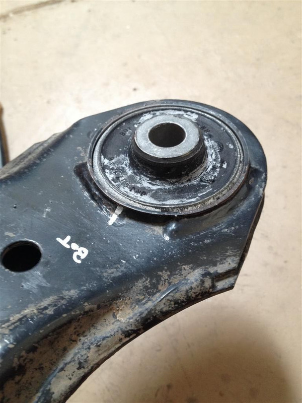

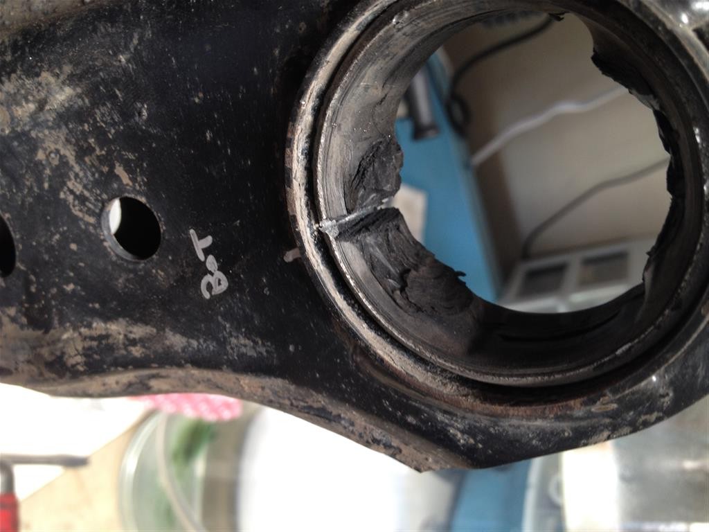

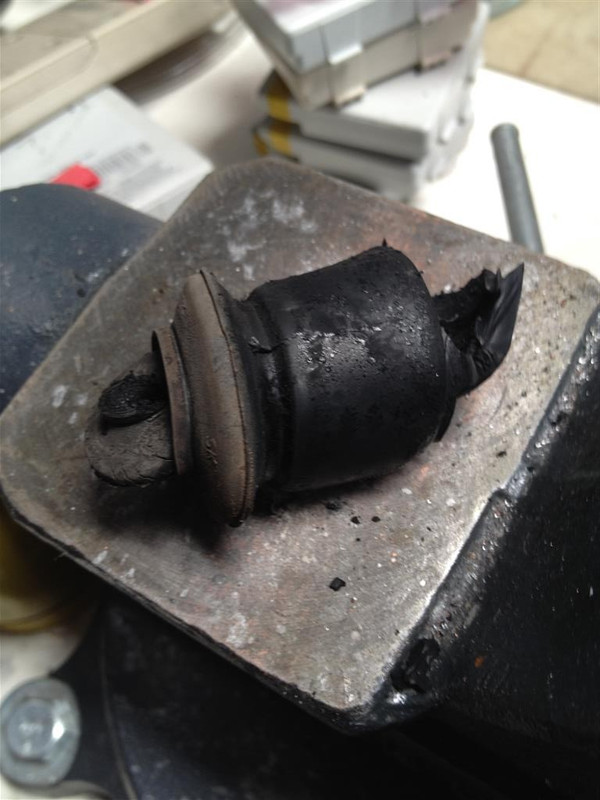

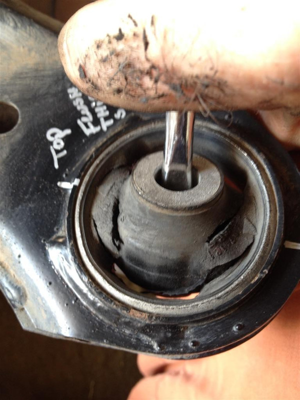

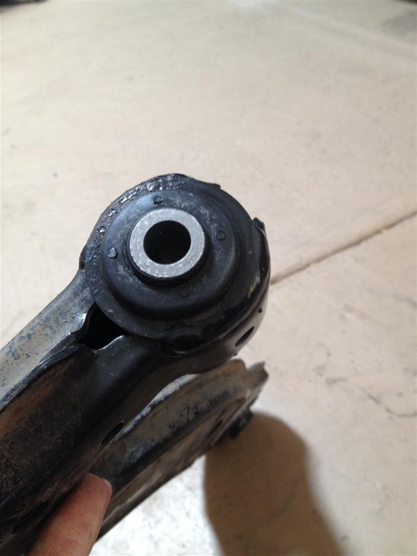

Both rear control arm bushings where cracked pretty bad. When I twist on them you can really see :(

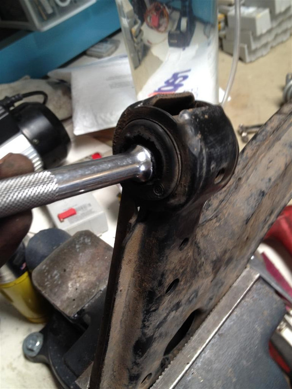

Got them out with ease. Just a little hack saw action and bobs your uncle.

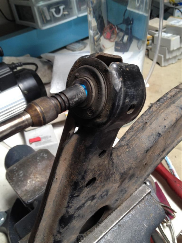

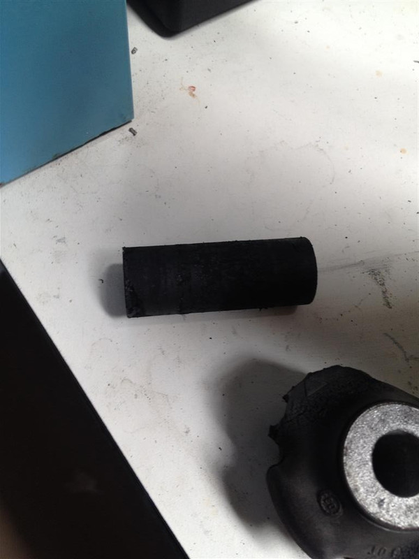

The front small bushings needed some heat. Got the metal sleeve hot, then pushed it out. With that out the rubber bits come out easy peazy
Pushed the new small bushing in with the vice and liberal amounts of palmolive dish soap

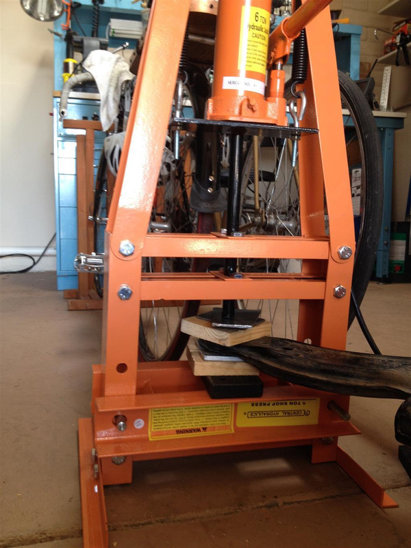

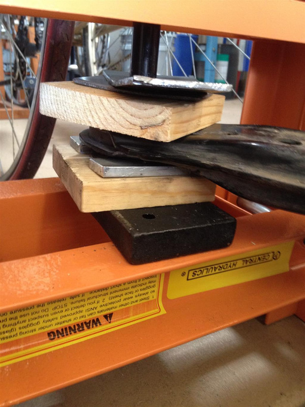

The rear ones were a little trickier. HF POS press some blocks of wood with a hole drilled in them and patience though and I got them in all nice like.

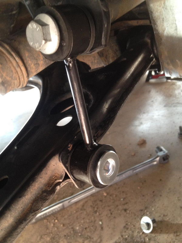

New anti-sway bar links and bushings too. What the heck why not
And... Tada, car no longer squeaks and groans when going over bumps. :beer: :beer: :beer:

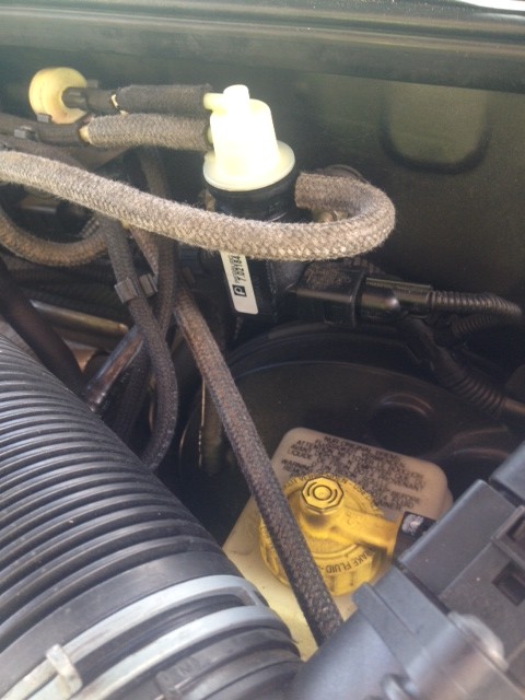

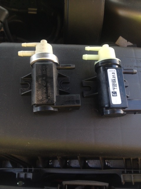

in pursuit of my every now and then limp mode I replaced N75. Even though it seemed fine.
Yes… This really is just me procrastinating buying that vagcom sw and tool. :retard: dag-gum-expensive
No drama. Two 10mm nuts and she comes off. Since I'd recently done the vacuum hoses, they came off without any issues.
FYI, I found that the most economical place to purchase was on ebay $55 with free shipping whereas IDparts wanted 70 bucks plus shipping. meh

Nice! Best tool ever made.
