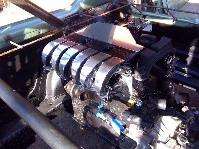

well got the blocks apart and found them both useless, one has a 2 mill lip in the cylinder wall, the other is egged out at the IM shaft. so we went to out machinest, and picked up matts other VR block which is in great shape borrowed a ball hone and put some beautiful X-hatching into it. got to order up new piston rings and bearing and put it all back together pics on this soon :thumbsup:

Well here is the latest, block is cleaned ready to be rebuilt and painted, and the firewall is starting to take shape :thumbsup:

nice!!! :thumbsup: :thumbsup: :thumbsup:
