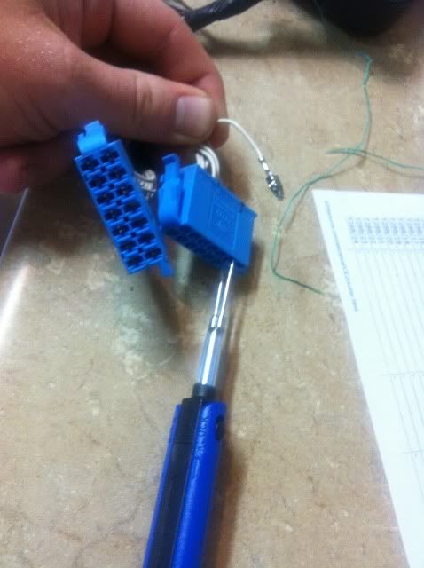

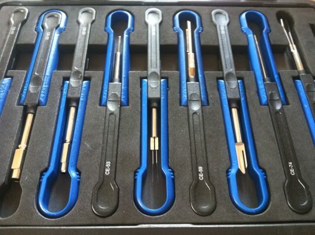

Oh............ and I can work on my wyres some more now. Got a terminal release kit. Works awesome on all VW connectors and plugs.

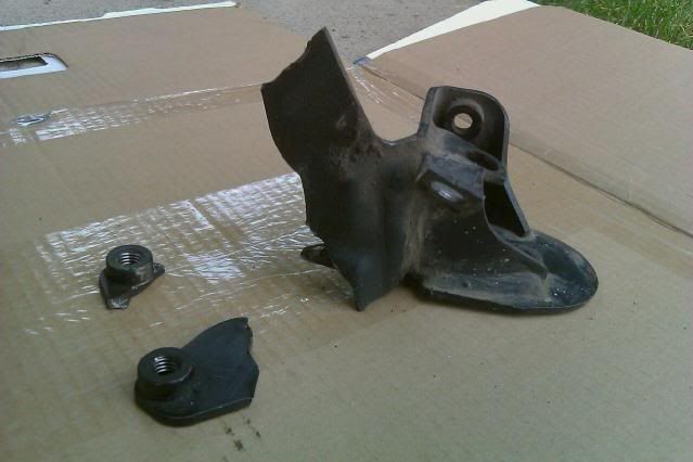

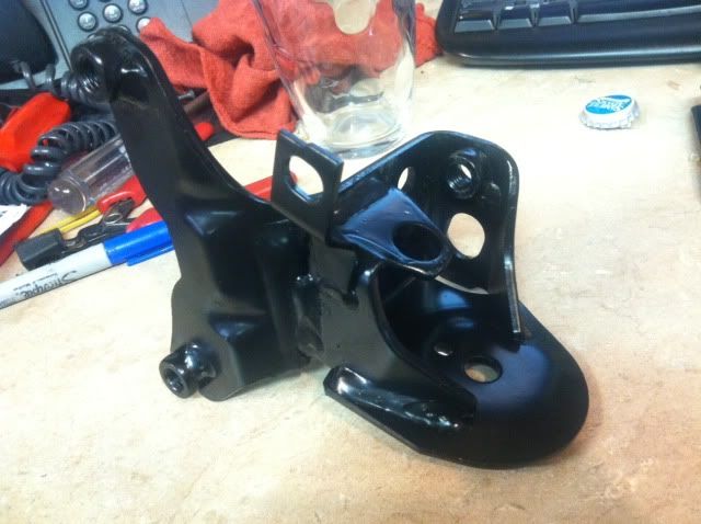

Looking at my motor mount after my buddy's busted into pieces on his B3, I found mine was welded back together too. So a thanks goes out to the parts people at MIG for going the extra mile and getting this hard to find NOS part from across the pond. A few places online say they have them, but they don't.

Nice OEM stuff!! Love that terminal toolset...jealous.
