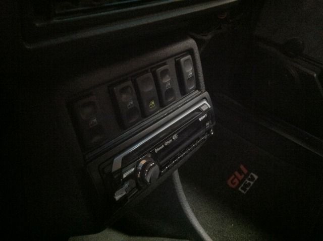

Got my tach working with the aide of the MSD 8920. Coilpack cars have a 12+ square wave from the ECU as a tach signal. If you want to use a "-"Coil driven tach you gotta get an adapter. The car falls flat on its face at 3500 rpm. Boost guage will be here this week so I can see what that is doing.

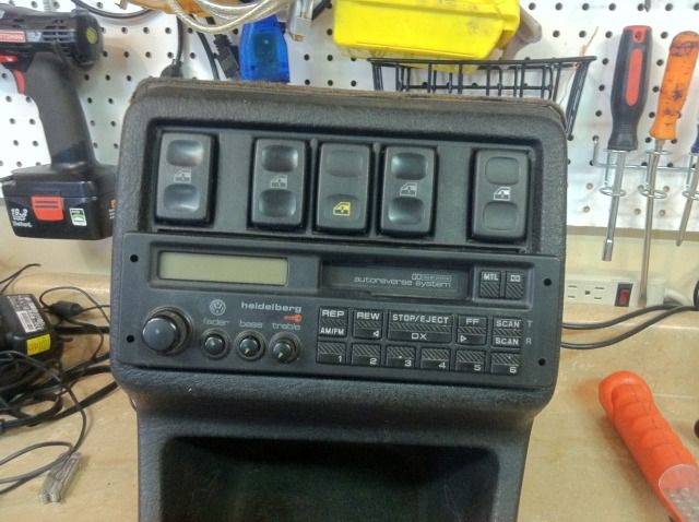

Sorry Jurgen but I did this and I like it. I have always hated the headunit glaring at me from the top of the dash.

Whoa nice man! I didn't know you had a stereo in there!

Why you apologizing dude? :beer: :beer: :beer: Guessing this opens up space to run boost gauges and whoo ha and what not up top?
Re: 20VTMK2GLI
Good info. I didn't know that about the tach. Oh and radio looks good. :thumbsup: :thumbsup: :thumbsup:

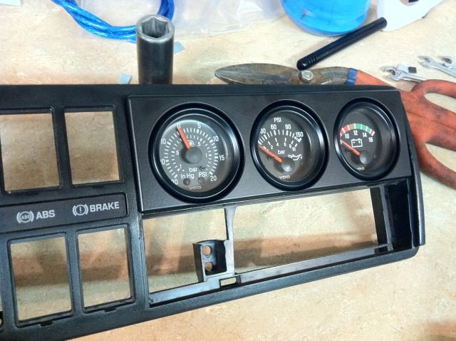

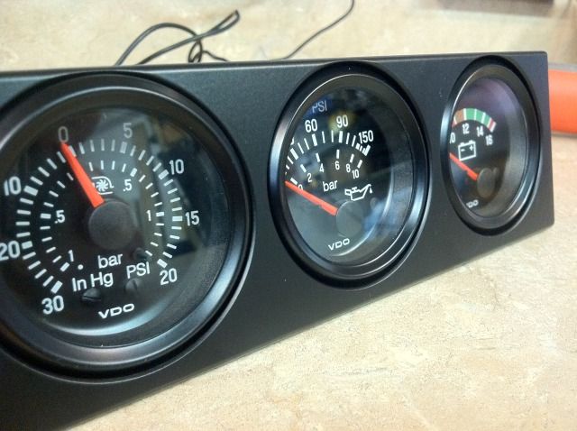

I'm beginning to wonder if this car is getting used to its new configuration. Did some data logging with a co-pilot on the Vag-Com and it seems to be running pretty well. I still think my cat restriction is a problem, but I'll deal with that soon. Turbo spools quickly spiking to 17 or 18 and holds 15psi. Fun to drive but I can tell theres more oomph in her.

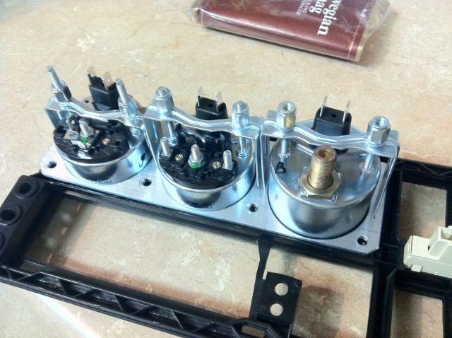

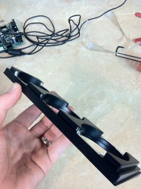

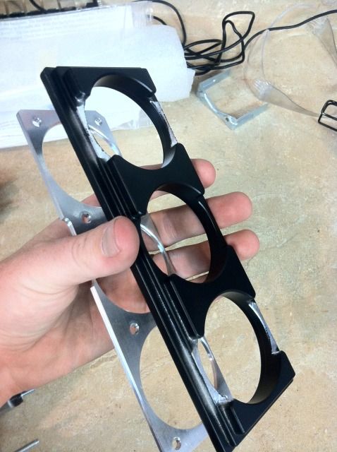

42draft makes a nice gauge panel. These are the Cockpit series gauges.

Re: 20VTMK2GLI
Looks great!, i need that boost guage!, been looking for one that looks simple, black and white face, but i need it to 30 PSI.
Re: 20VTMK2GLI
Wow, those gauges look great. Gonna be a perfect fit up where the radio was.
