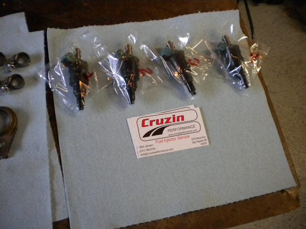

Major progress; injectors (post-clean) showed up today.
Installed the injectors and tried to start it, and it just stumbled like it was before. So I ran through the wiring harness again, and traced a wire back to the ECU that seemed out of place. I disconnected it, and the mofo started right up and ran!! After a while of messing with the throttle cable and setting the timing to 7.5 BTDC it runs really well, and starts right up every time.

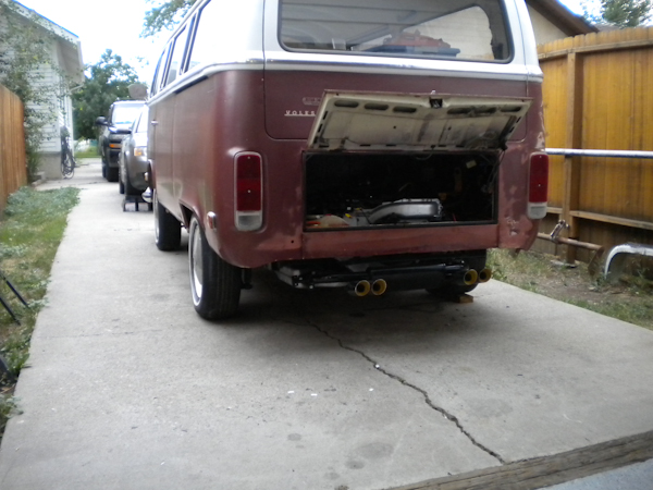

Here's a short video
Re: Projekt Uber Geizig 1972 VW Bus Deluxe 9 Passenger
so that's what 40hp of furry sounds like.
- Posts: 535
- Location: East of Hell
70 hp stock for 2.0 type 4. cool video. good luck on the 1st drive.
Way to go Mike. Heard some gears grinding. Now for a clutch adjustment. Nice
hats awsome!!!!!!!! glad to hear it running!!! an i like the fire egstigusher in the video
Looks like the Avant is up on ramps?
