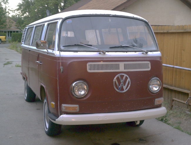

Thanks guys, yep those were some gears grinding :laughing: The clutch isn't releasing fully, so I'll need to adjust the cable, and hopefully I have the correct clutch, TB and everything will adjust out correctly.
Jason- It was making a hell of a racket, and it turns out because I have a busted motor mount, the bottom of the trans was knocking against the skid plate. So, I pulled the skid plate in prep to install a passenger motor mount and snub mount. Probably order those next week.

Haha, agreed. I am soooo close...but, well, something is up with the clutch, and it won't release. I am almost sure now that I have the clutch disk in backwards. I didn't see any clear markings that said "FW" or anything so I just bolted it up like I thought it should be, apparently the wrong way. Anyway, it's an easy fix, but I have to pull the motor. I need more practice anyway, plus it gives me an excuse to go buy an ATV jack now hah.

Pulled the motor, clutch was in OK. :smirk:
Started to take a closer look and then test fit the clutch disk...uh it was sticking an binding up. Well after a bit of wire brushing and a little grease it was smooth. So, motor goes back in and it's (mostly) bolted back up, and the clutch works now. Took it for it's first spin down to the corner and back :cool:
Still have a bunch of work to do, but the bulk of it is now behind me :thumbsup: Try to get some of it done by the Euro Show :paranoid:
