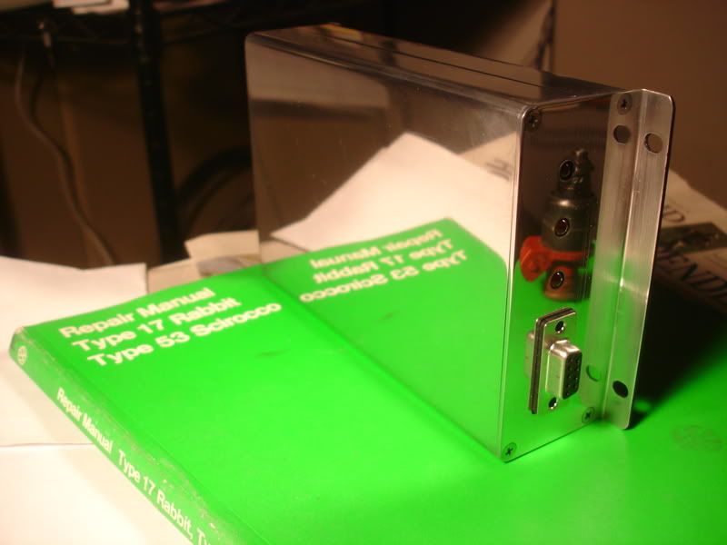

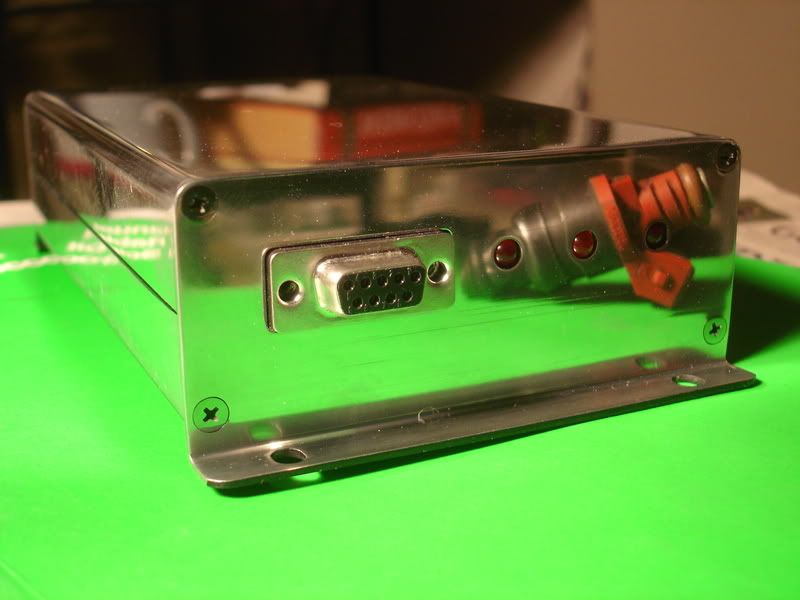

The pictures don't even do it justice, in person that megasquirt is friggin pimp!!!

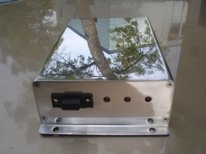

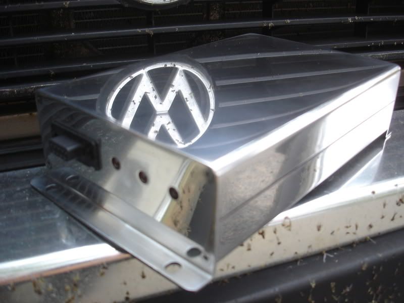

by t53a » Sep Sat 20, 2008 10:04 pm
maybe these pics will do the MS justice...

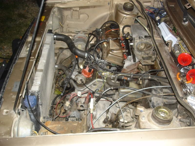

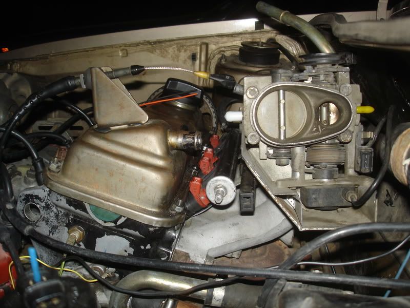

been hard at work today
passat 16v auto tb
port matched intake all mounted along with fuel rail/injectors

Did you use that TB for the Throttle position sensor? Just curious. I thought it might also be for the really small primary
Also which manifold did you use? I have heard that the Fox manis flowed better for some reason

yep using the passat TB for the TPS for the megasquirts.
the intake/head is from 84 GTi JH. bottom end is RD 10:1 comp.
both head and intake are P&P
