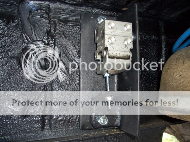

Rear Brake Proportioning Valve Fab
Rear Break Proportioning Valve
Fabricated the remote mount with manual adjustment for biasing the rear brakes.
Installed it today by mounting it to the rear wall of the cab.
Good spot where lines terminate to go forward and back out of that unit.
Also a conveinient spot for manual adjustment when tunning it in.
Another "mini project" out of the way!
I'll work on running hard lines from this valve to the rear disks next.

Awesome! Does that really say "France ------>"

Yes... according to the Bentley that arrow must point towards France when adjusting the valve...?
