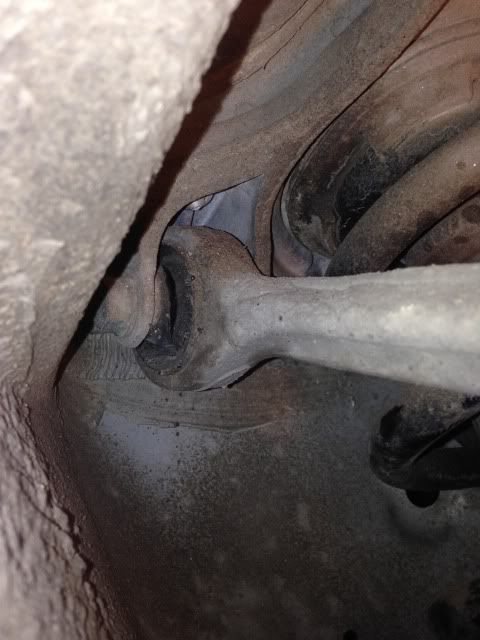

After bozeman Audi said the front end was solid and charged me a premium for an alignment, I replaced all the worn out control arms and tierod ends on the a4.
Did both upper and lower with the HD upgraded set.

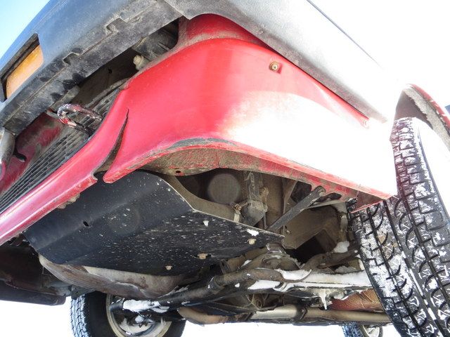

On another note, my 4K never came with the lower radiator shroud. For some reason, Audi decided that it was a good idea to use cardboard for a piece that takes the brunt of the weather. I couldn't imagine them lasting more than a couple seasons so today, I made a quick bracket and an aluminum skid/shroud to prevent any debris from coming up off the road and killing my radiator. I used some scrap aluminum sheet, aka roadsign, and bent it over some steel to form the angles. I really need to get my brake press constructed as wailing an oversized hammer in the garage seems to make my daughter's naps really short...A little flat black and the 4K is even more ready for snowmageden...hurry up!

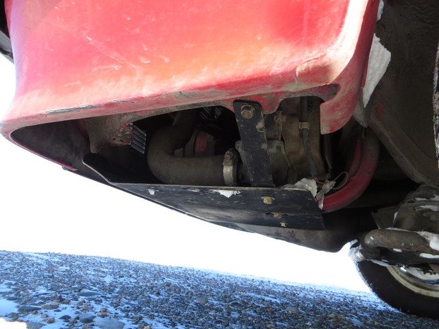

Here's the aluminum shroud that I bent up to protect and direct the radiator. Don't mind the cracked spoiler

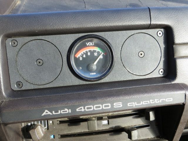

Also made a gauge plate to replace the center fresh air vent. Only one gauge for now so the others get blanked out:
This gauge is from '77!
