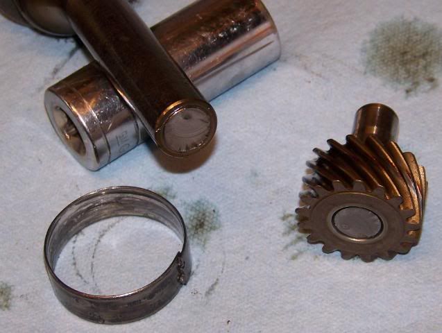

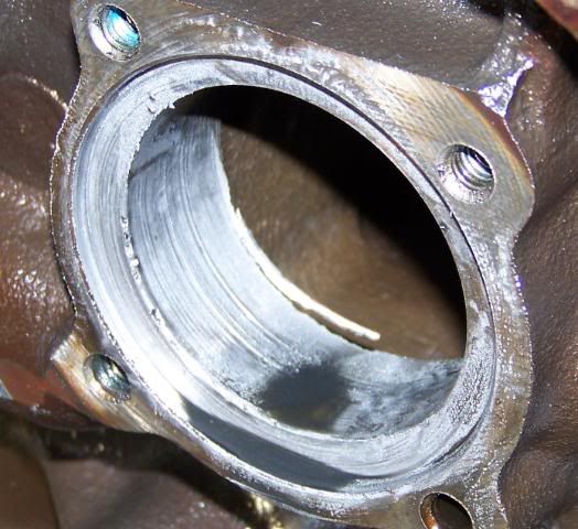

Well, the conclusion to my saga:
Looks like that bearing toasted and kept going for a while. I lost oil pressure when the intermediate shaft broke. This does not look repairable. :\

omg wtf that is nuts! I have never seen or heard of anything like that from a vr6. I have heard of intermediate shaft bearings going, but not that bad. O_O

damn look how clean that break was..... the forces to make that happen are incredible. with how much load an IM shaft has, thats pretty unexplainable.

kompressorgolf wrote:damn look how clean that break was..... the forces to make that happen are incredible.
The heat generated by the bearing failure, helped it break cleanly.Ouch
I spun a bearing and broke a crankshaft, looked similar.

I wonder if there is such a thing as an overbore bearing for that? I bet a talented machinist could clean it up and maybe add some metal and then grind it back down to spec. May cost too much $$ tho...I bet you can find another VR block or motor somewhere for a few hundo.
