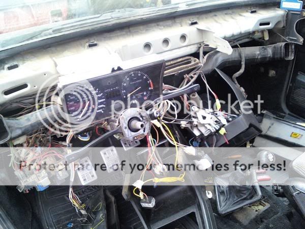

Worked on the Rocco this weekend. Rebuilt the front brakes, one calipers seals were fairly dry and had cracked. Pulled the dash off, found the short in the clock/radio/cigarette lighter/interior light curcuit, one wire rubbed through. Also found a loose wire coming from the blower motor, hooked it back up and it works now :D . Decided to try to fix up the cracks in the dash as well as possible, almost done. Taking the dash off makes working on the wiring so much more easy.

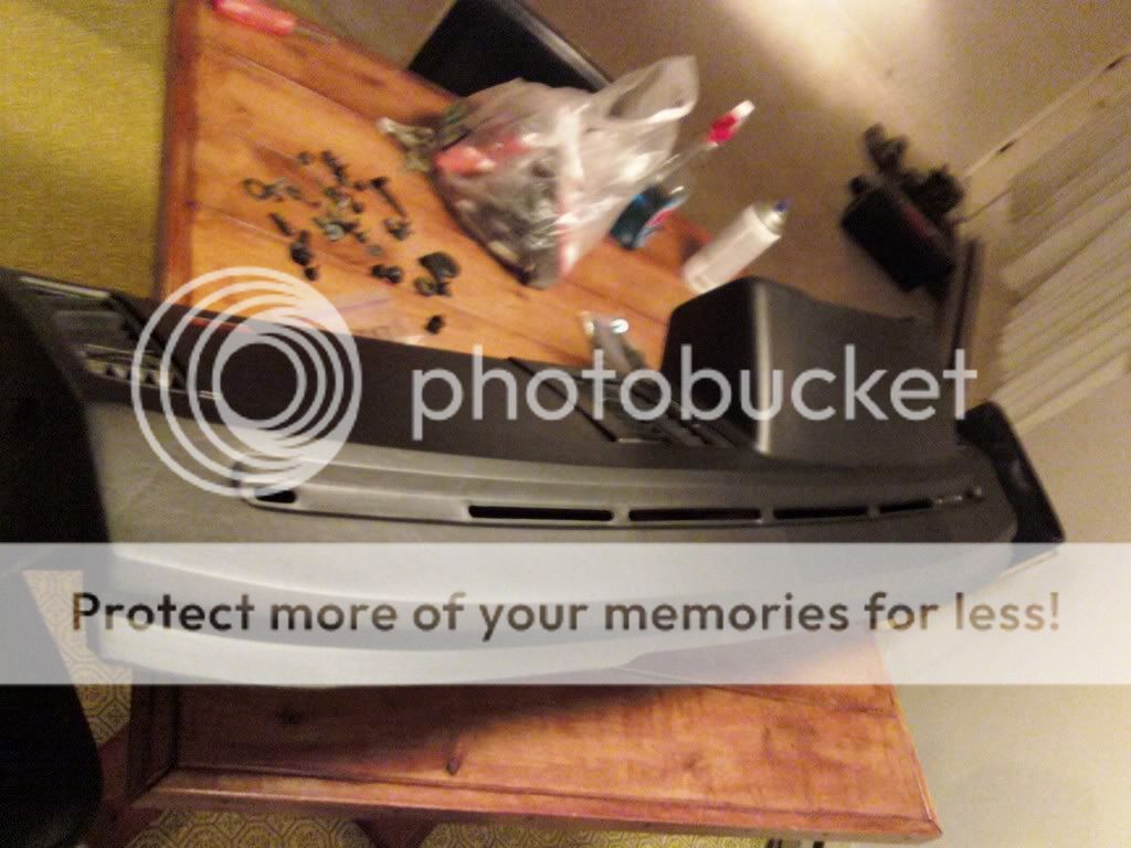

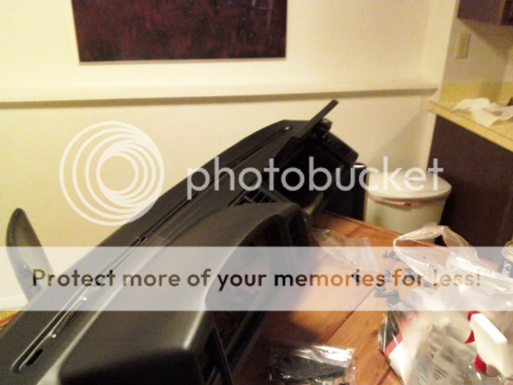

Didn't take before pics. you can still see the cracks but they are better. Fixed the glove box, stays open(thank you JB weld).Image

What did you do to fix the cracks in the dash? kinda curious..
Mrbubblehead
Posts: 439
Location: Belgrade, MT
Re: !!Tek's Rocco Progress!!
Post by Mrbubblehead »
I used black silicone then buffed it down with some 220, and then used vinyl paint. I read it on some forum. They do make a specific filler for the dash cracks, but it is pricey. Next time I'll buy the good stuff.
