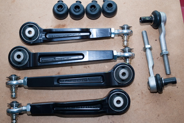

These 034 Motorsports adjustable upper front control arms, plus another set of outer tie rods are going in soon:

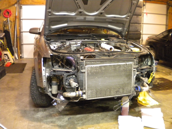

After that the next job was timing belt and new radiator:

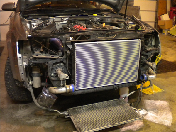

Busted out the tools and got to the core, put it in service mode
Old leaky radiator out

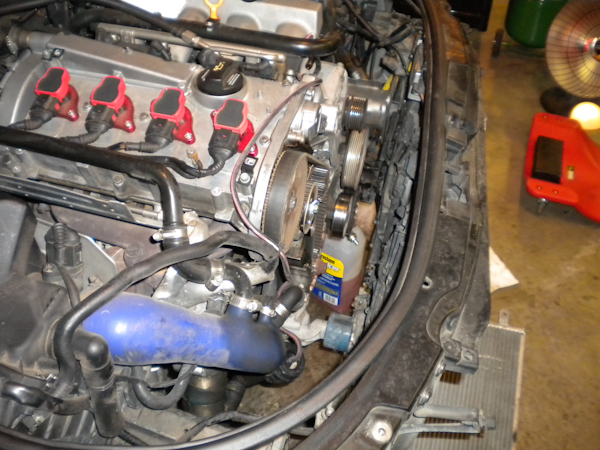

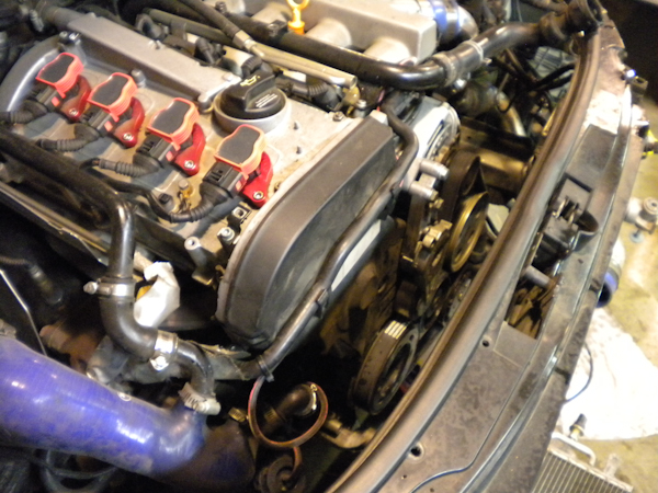

Pulled the timing covers and got to the water pump and tensioners

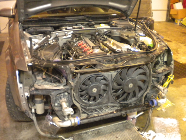

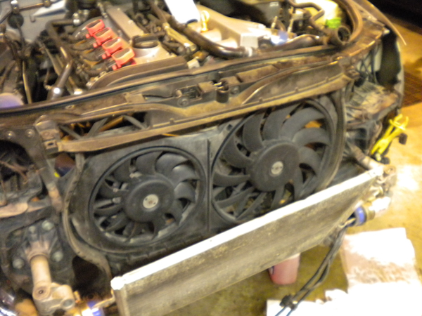

You can kind of see things through the radiator fans :laughing:

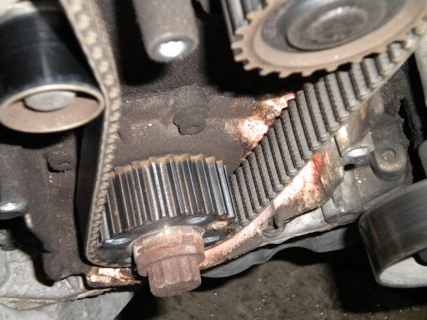

My water pump seal was leaking a bit... :\

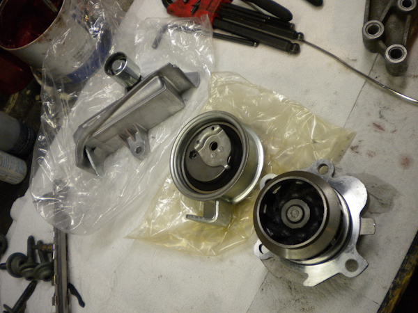

New parts prepped for install - all German parts, no cheap $hit.

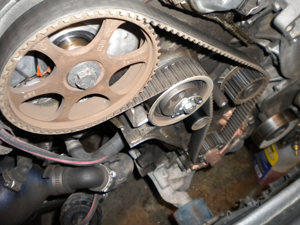

All installed, timing belt lined up and ready to pull the tensioner "grenade pin"
All ready to run
Don't forget that new radiator!

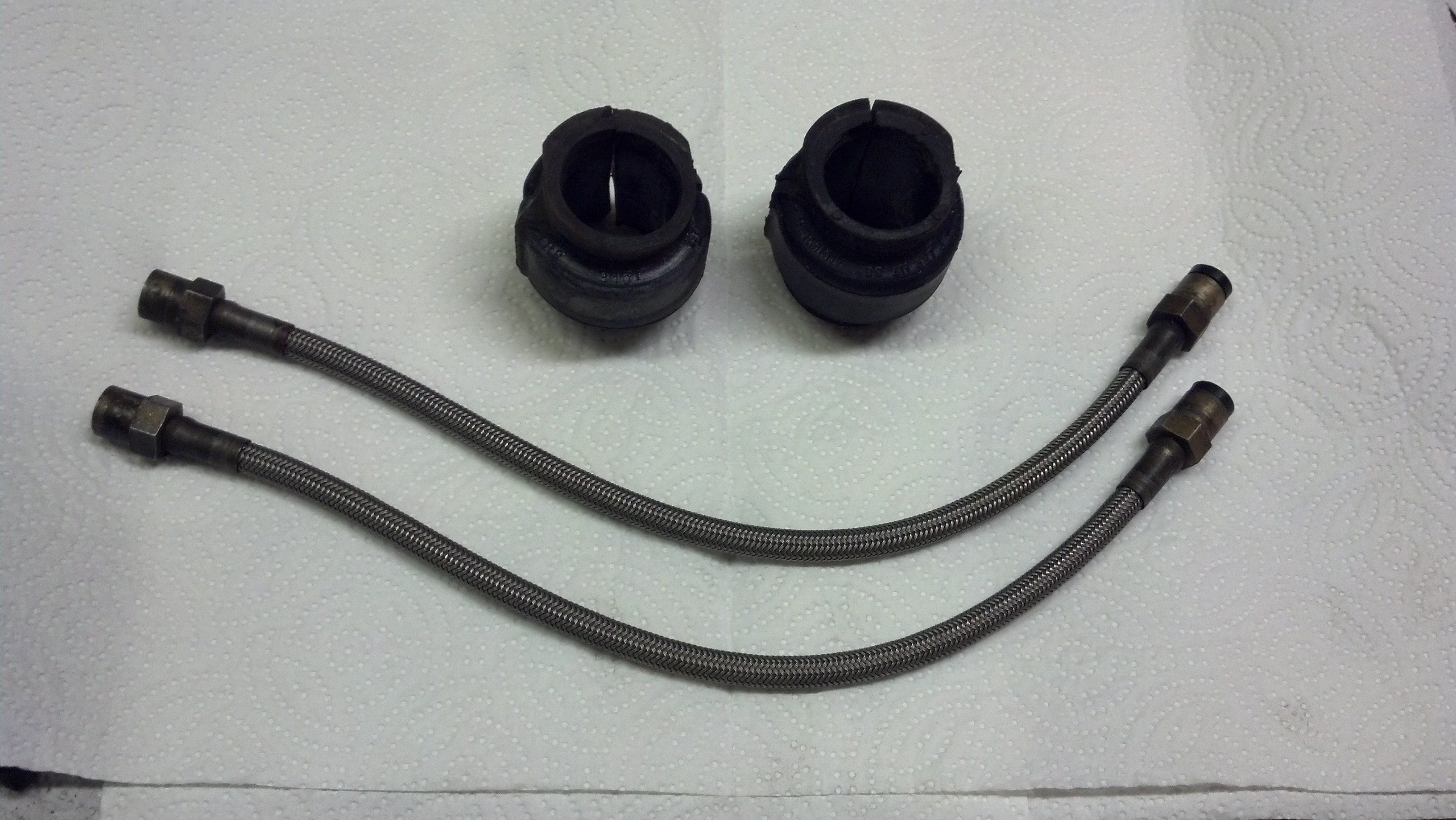

And...new-to-me Neuspeed stainless front brake lines (and sway bar bushings)
