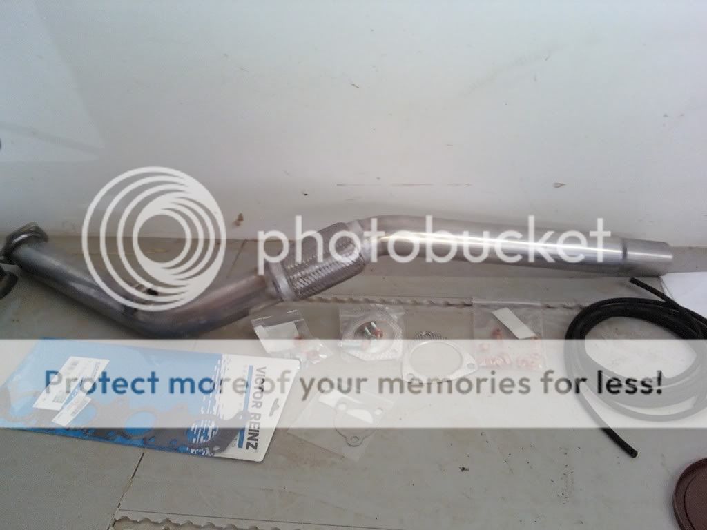

I took the Passat camping up in Eureka, MT. The exhaust leak got worse. After 3k it gets loud and I feel a sufficient power loss. I also tested out the new skid plate(not intentionally). After the hit i got out to look at the plate and someone asked "how is it?", my response "awesome." I ordered a new TT downpipe, new copper nuts and every gasket from the head to the DP. Might as well go through them all. I think I'll polish out the inside of the manifold when i have it off and paint it. On a side note, the camping trip was awesome. That is some beautiful country up there.

Replaced the suction jet pump and a bunch of check valves(i still need the one with the extra port on it). I found a tear in a tube that goes to one of the check valves, fixed that. So far, it feels better. Throttle is no longer jerky, not shaking at idle, acceleration is smoother, and slightly more power. The exhaust leak continues to get louder. I'm going to deal with that next weekend. I have all my parts for that job. I hope that fixing the exhaust leak will return the power that was lost after I hit that rock. And that the TT downpipe and porting the stock manifold will give me a little more power :unibrow:
