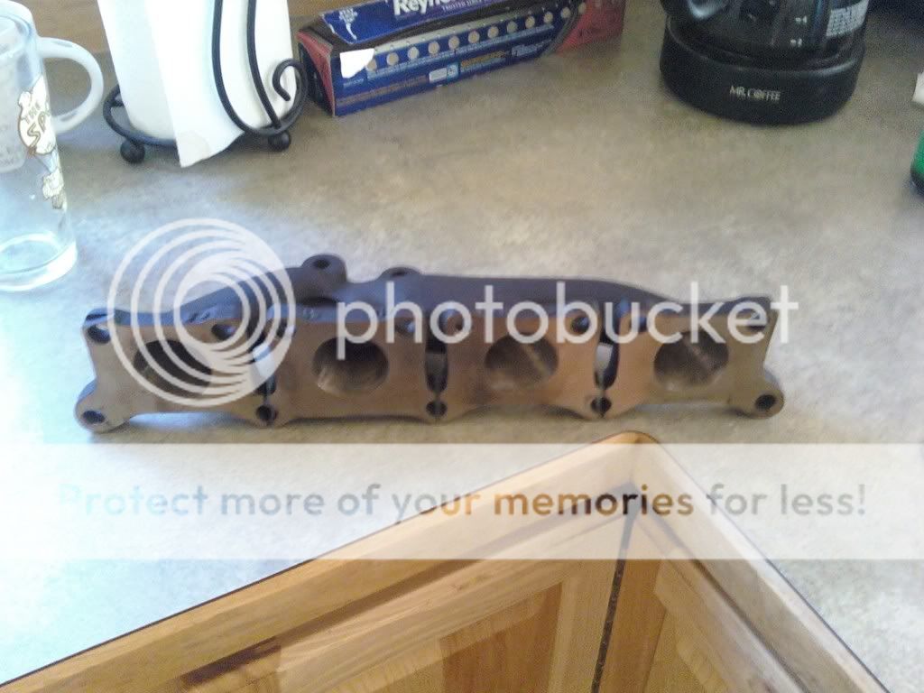

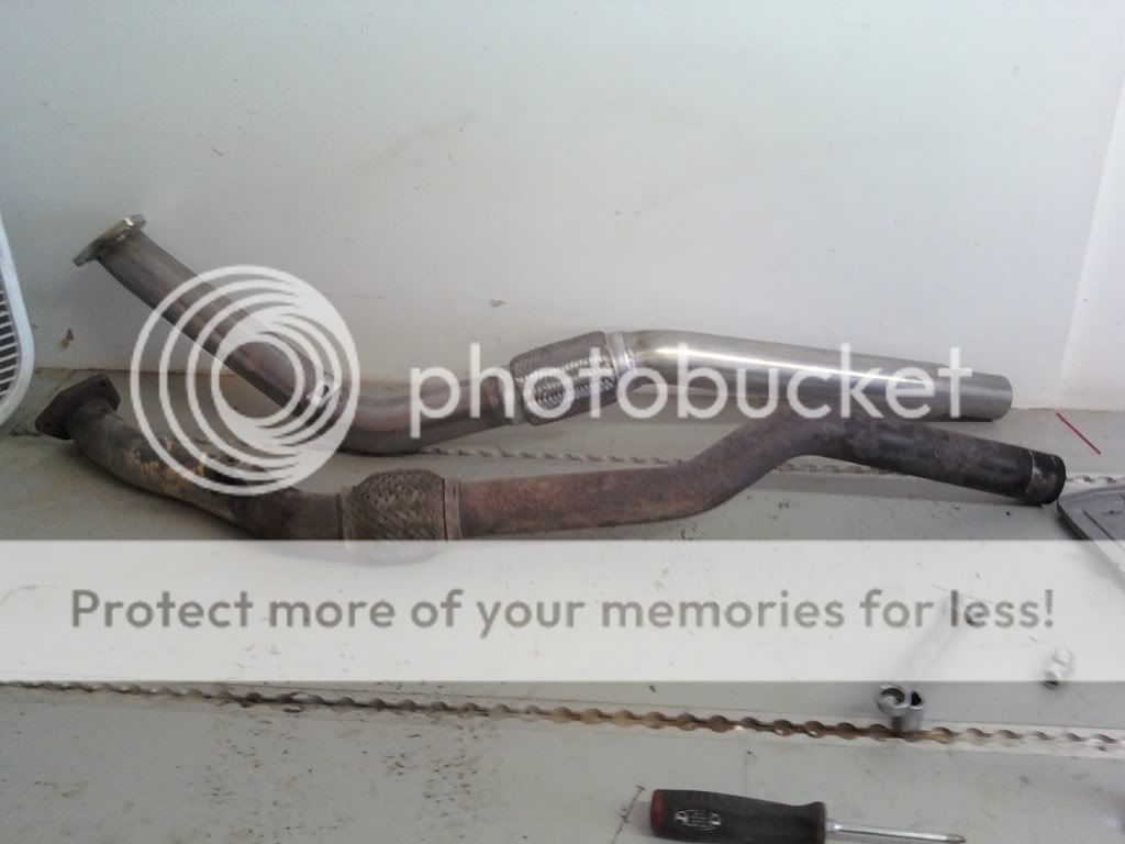

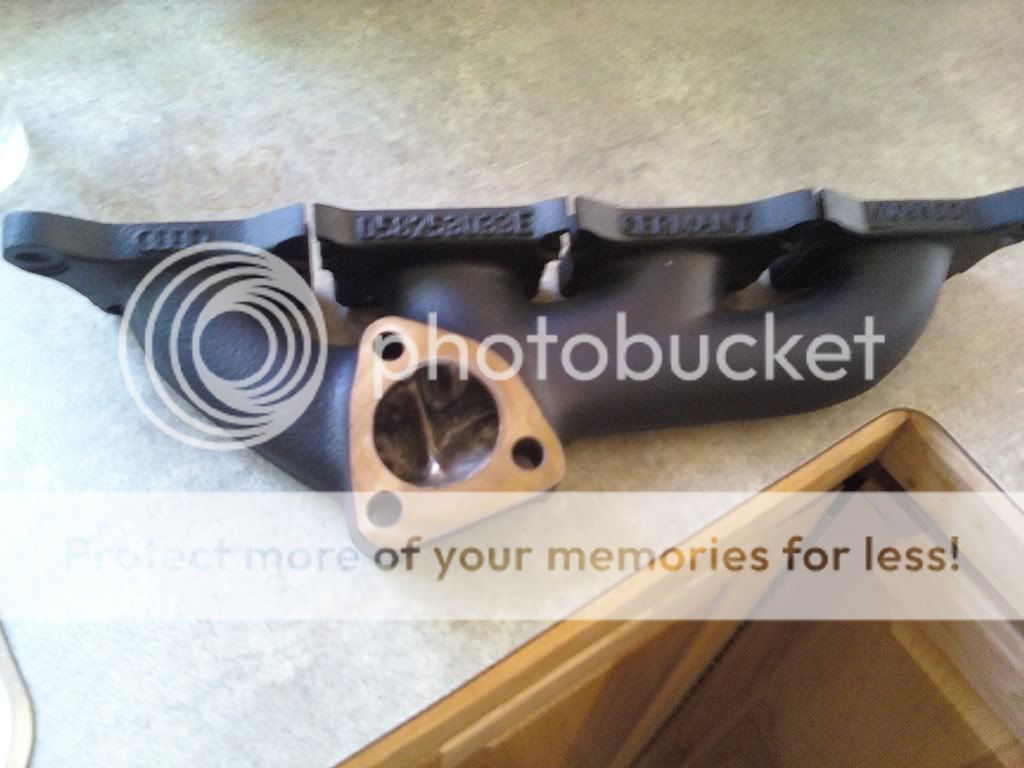

Exhaust is all done. I removed the manifold, down pipe, and all associated gaskets. The outlet on the manifold was noticeably smaller than the gasket. The inlet on the turbo was the same as the gasket. So i matched and did some porting and polishing on that sided. On the inlet side of the manifold, I just smoothed out all rough spots, leveled out some hi spots and polished as far in as I could reach. Then I painted the manifold. The exhaust got all new gaskets and hardware. It wen back together pretty well, the bolts between the turbo and manifold were kind of a pain to line up. I ended up just buying a stock diverter valve locally and putting it in. Also cleaned the rear O2 sensor connection, it was getting an intermittent signal code. Got every thing back together and went for a drive. At first i really didn't feel much of a power difference, but it was idling smooth, accelerating smooth, and no longer falling flat on its face coming out of first. After around 50 miles of driving power started picking up(not sure if the ECU was still running it like the diverter was bad and the exhaust leaking and it took a bit to figure stuff out) It pulls really nice now. Most of the power feels like it was gained between 2000-5500 rpm. The TT DP is a little louder than the stock DP. Then I got a CEL I've made an appointment with Dr. Trevor to scan it today. We'll see what this thing wants now.
