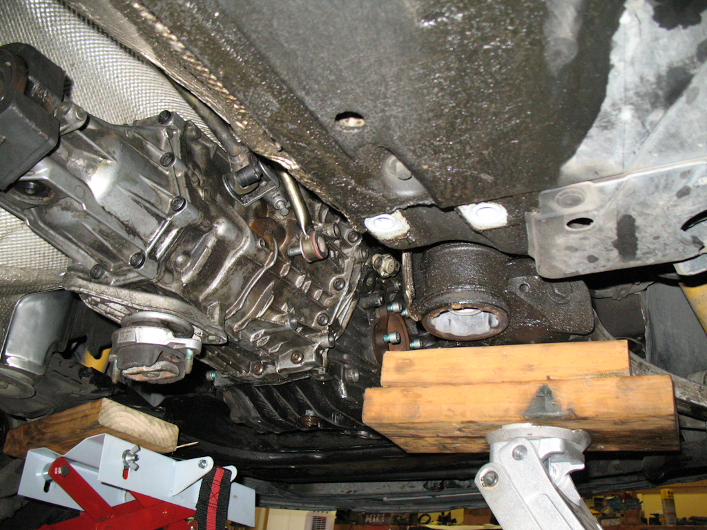

More work last night.

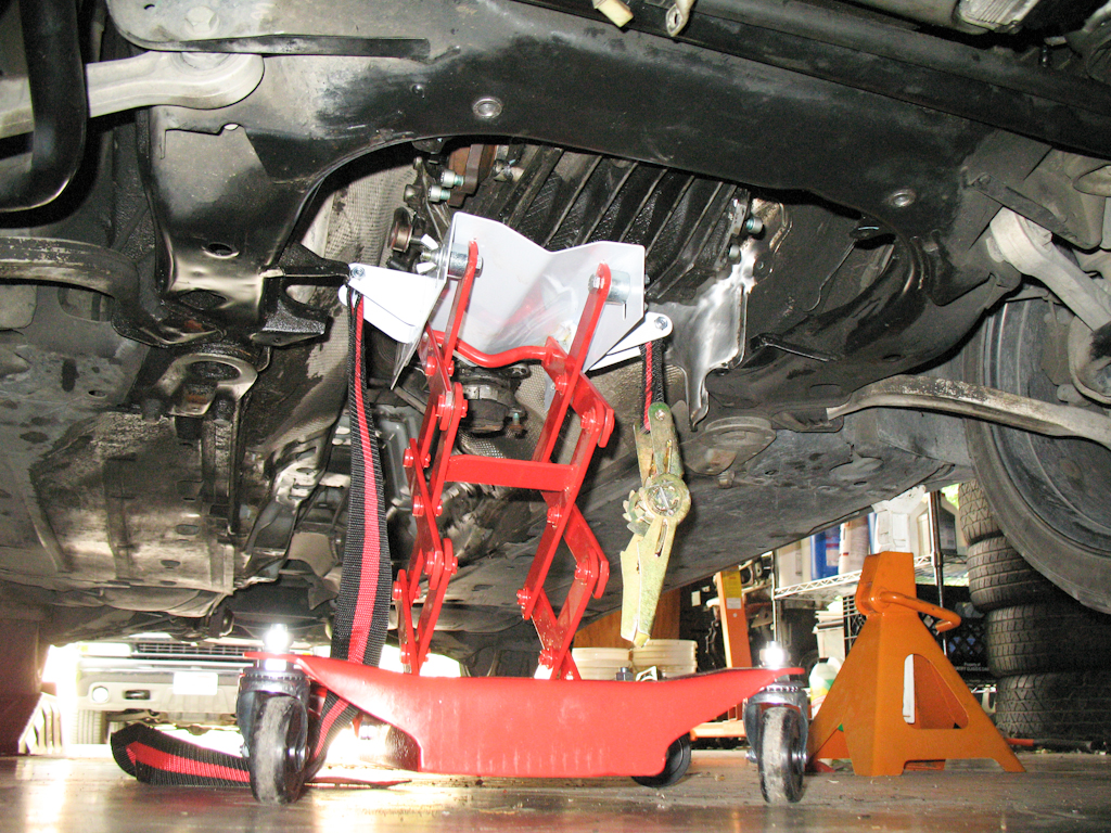

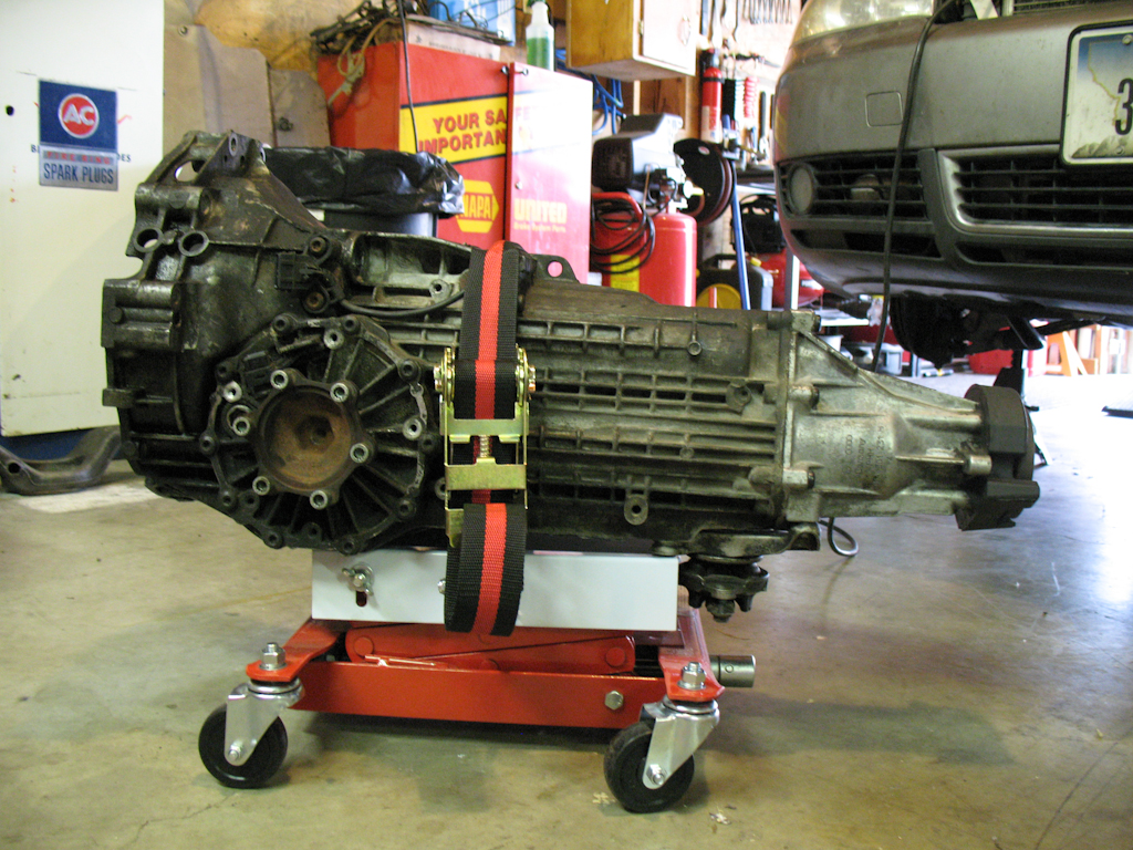

Ended up picking up a trans jack - just a basic one from Harbor Freight. Worked great :thumbsup:
Trans strapped in and ready to go under the car:

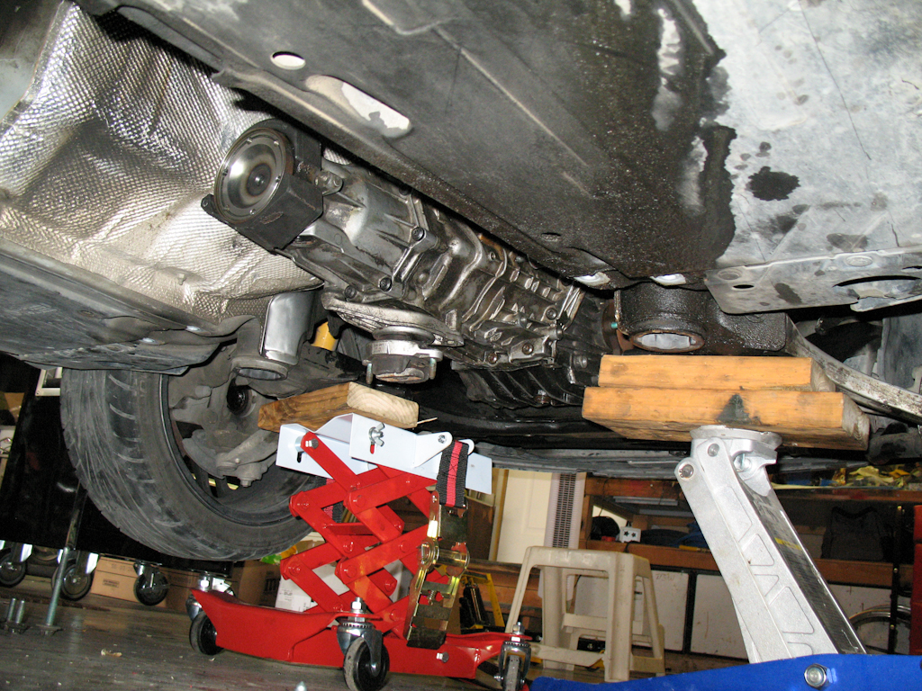

Up in the tunnel and mated to the motor:

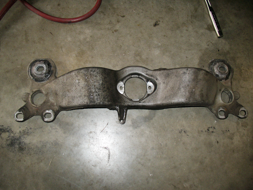

Removing the auto sub frame supports:

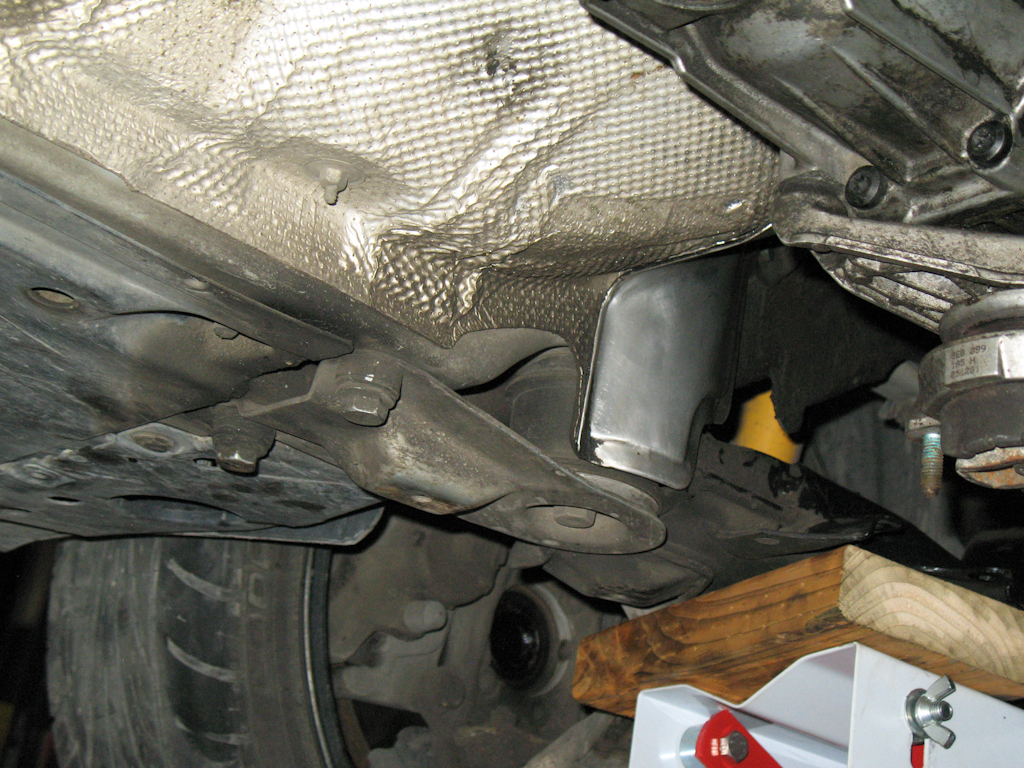

Sub frame ready to go in:
Holding the subframe up with a couple of jacks:
Bolted in and torqued to spec:
After getting it installed I was able to get the slave cylinder installed and hooked up, then I bled the brakes and clutch with some new Pentosin Super Dot 4 fluid. Clutch feels really smooth!

Whats the oily mess on the passenger side?
Re: Mikewire's Audi A4 Avant 5 speed swap
Power steering rack. I'm limping it along until I finish up the swap. Maybe I'll replace it next summer, dunno. Needs a control arm replacement first.
