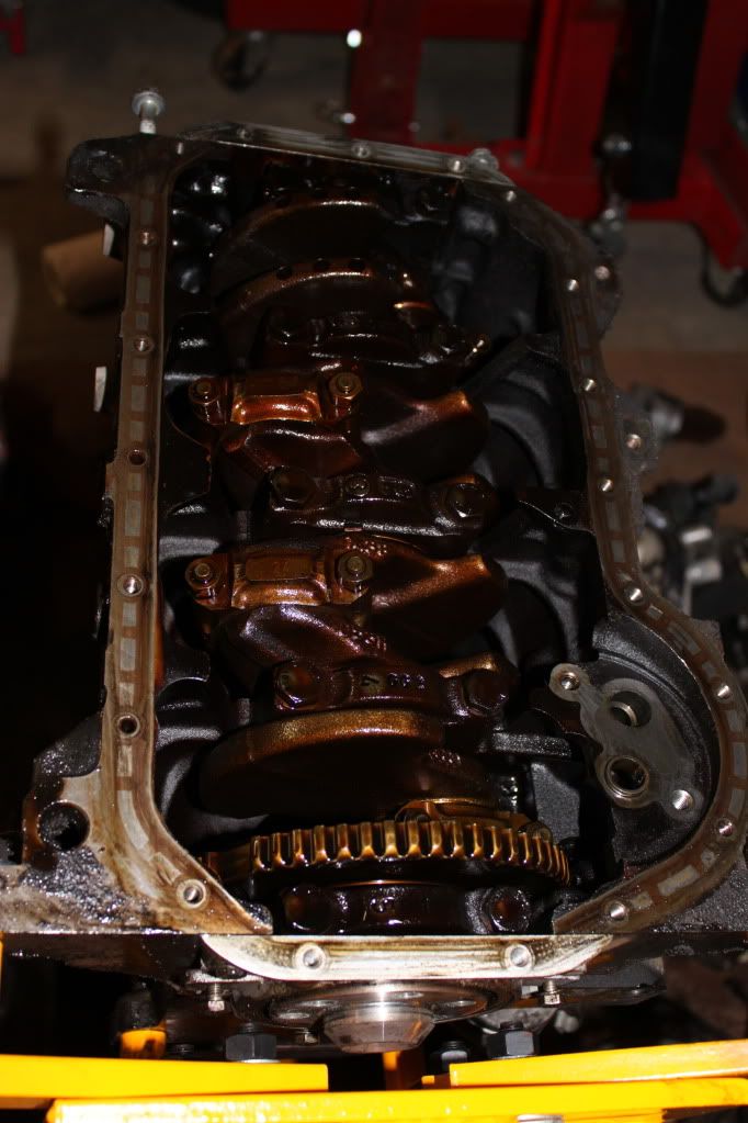

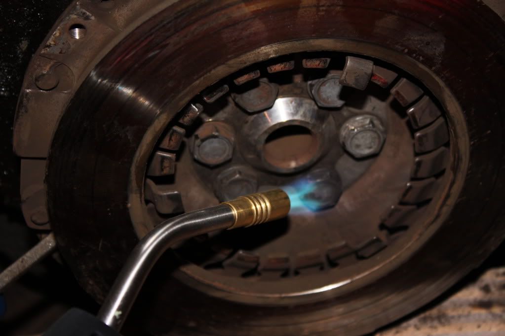

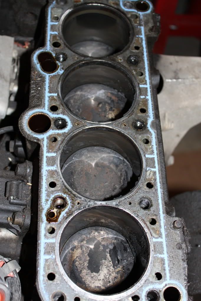

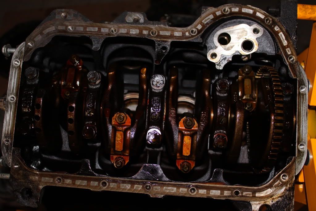

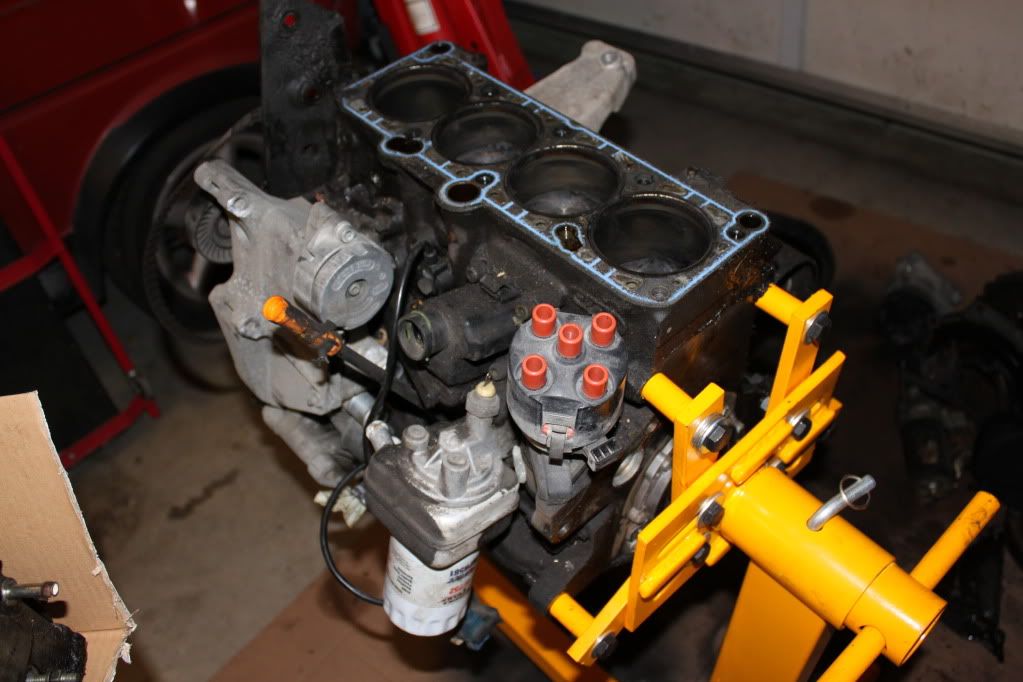

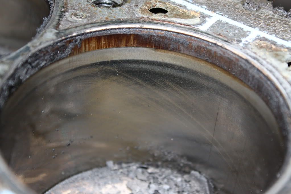

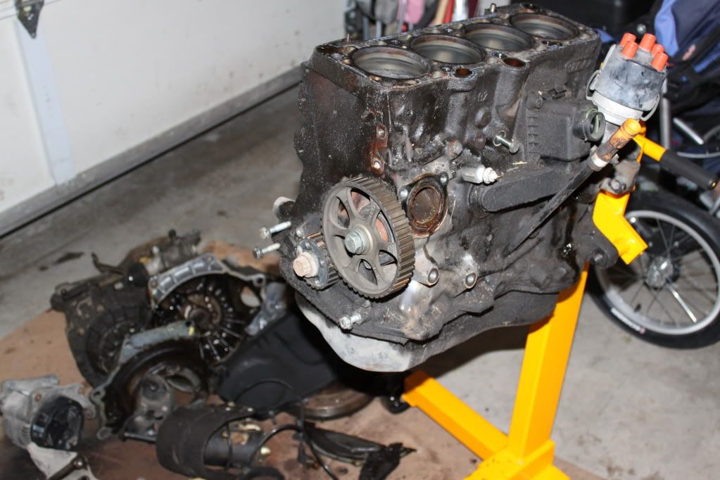

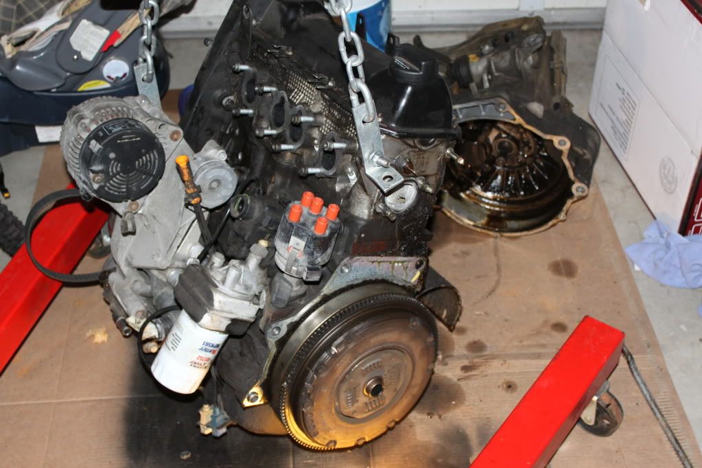

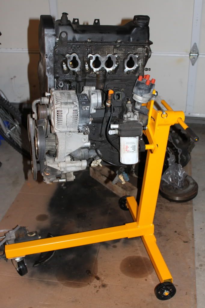

Some tear down pictures of the ABA.
Got it down to the block, crank and 3 pistons.
Fun time getting flywheel bolts loose
Got er on the engine stand finally! Time to go to work!!!
Head off
Cross hatching still looks really good though!
More to come soon.
Head off
More to come soon.

Re: Veedubya's MKI GTI Teardown & Build Thread......
looks nice and clean in there too. thats a great start. should take to boost well! i see the GTI off to the side there!
