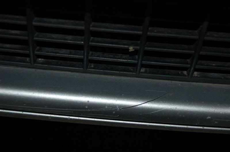

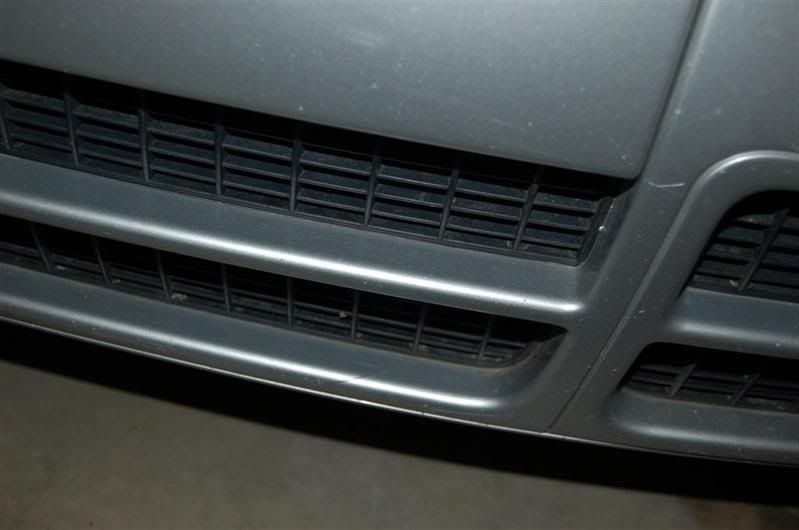

As of a result of being stupid the other night I cracked my front bumper at the bottom. I was/am so f-ing pissed. I don't like snow as much as I used to anymore. Although its not that bad, is there anything I can do to fix it? I'm just pretty damn meticulous about my car. I also don't want it to spread.
Here a quick shot I just took.
S4 driver
2 words.......plastic welding!! find a good body shop!!
actually this is going to sound bad, but if you drill a small hole at the end of the crack it may stop the crack....similar to stopping a crack in a windshield.............
