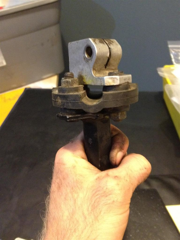

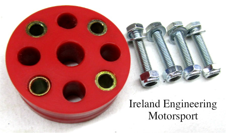

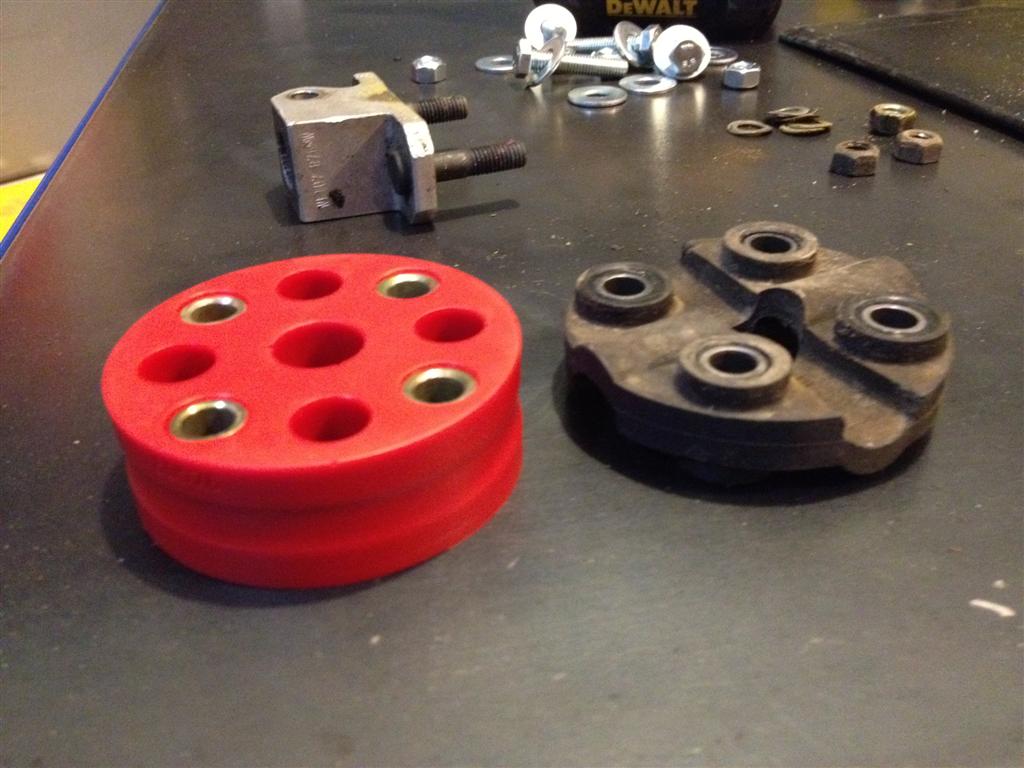

For those interested this is the steering guibo. (The rubber disc there) It's function is to absorb road noise and vibration from making its way up into the cabin.
To be replaced with this guy from IE

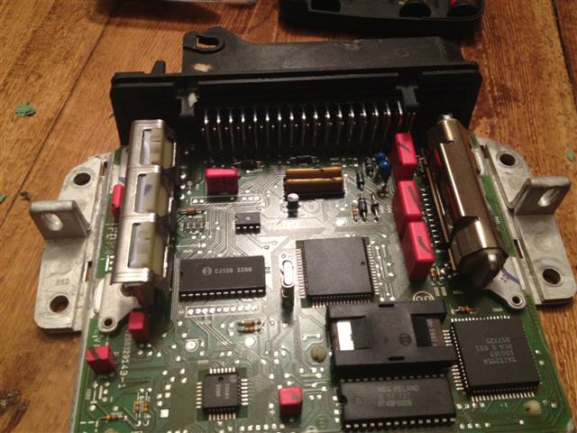

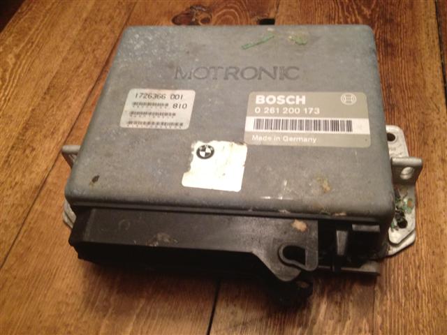

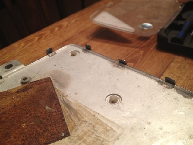

I scavanged a ...173 DME. Looks kinda rough on the outside
Bent the tabs back and popped it open
Looks just fine. Turns out I'm fairly certain I already have one in the car, but hey. Spare.
The "173" is the latest DME available in the E30. It has all the latest goodies and even some basic diagonstic stuff like the "stomp test"

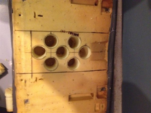

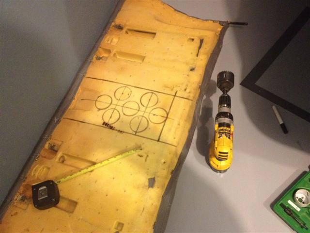

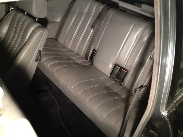

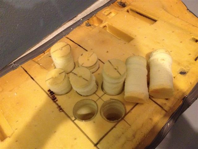

Next up, re-install the back seat. It makes me nervous with the sub showing like that. People might think something was worth stealing :thumbsdown: I cut out some of the foam in the back of the seat so as to not muffle the thump as much. First I measured.
Then cut these out, reverse direction with a hole saw sans the middle spiral bit.
Makes nice little squishy things
Back in place all covert like :ninja:

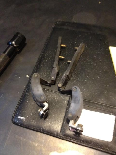

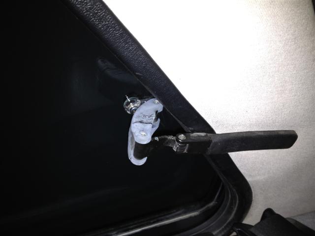

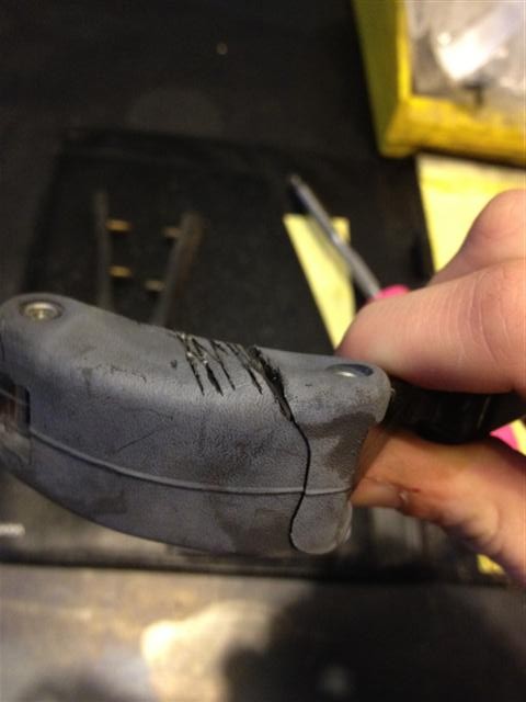

I had a busted wing window latch.
In fact looks almost like someone tried to cut through it at one point with string or cable... :\
whatever... I have replacements

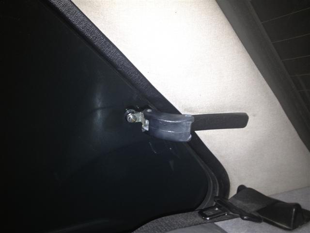

Put that bad boy on and good as used. A couple more soakings with 303 and I think it'll turn black again.

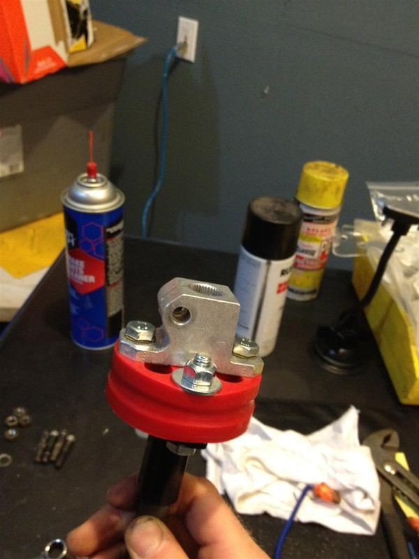

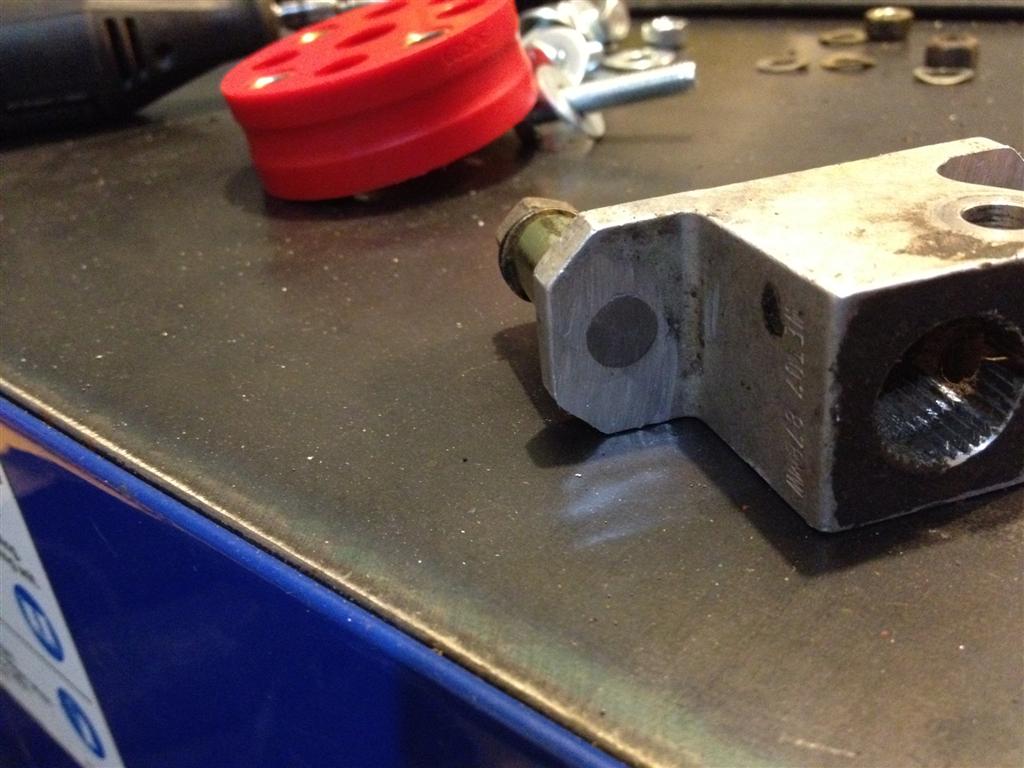

Here's a side by side of the old guilbo vs the new one. Wow, big difference.

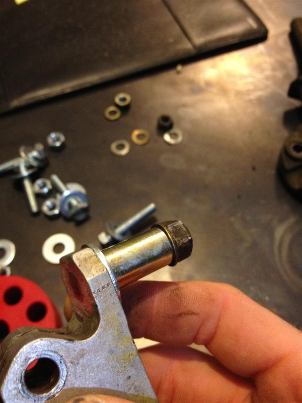

The original shaft halves have pressed in stud/rivet things so I ground the heads off
I just used a spacer and the original nuts to pull the stud through after the head was ground off

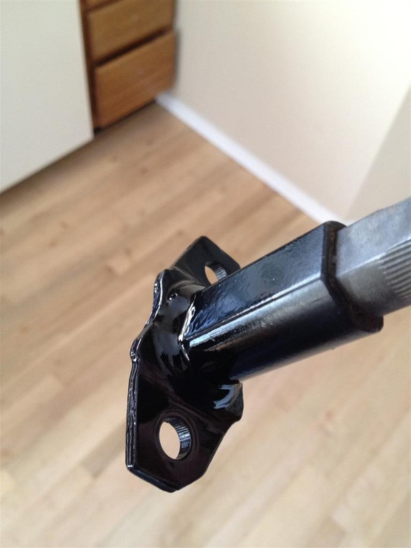

I ended up removing some of the paint on the steel end, so a fresh coat was applied
All dry and reassembled

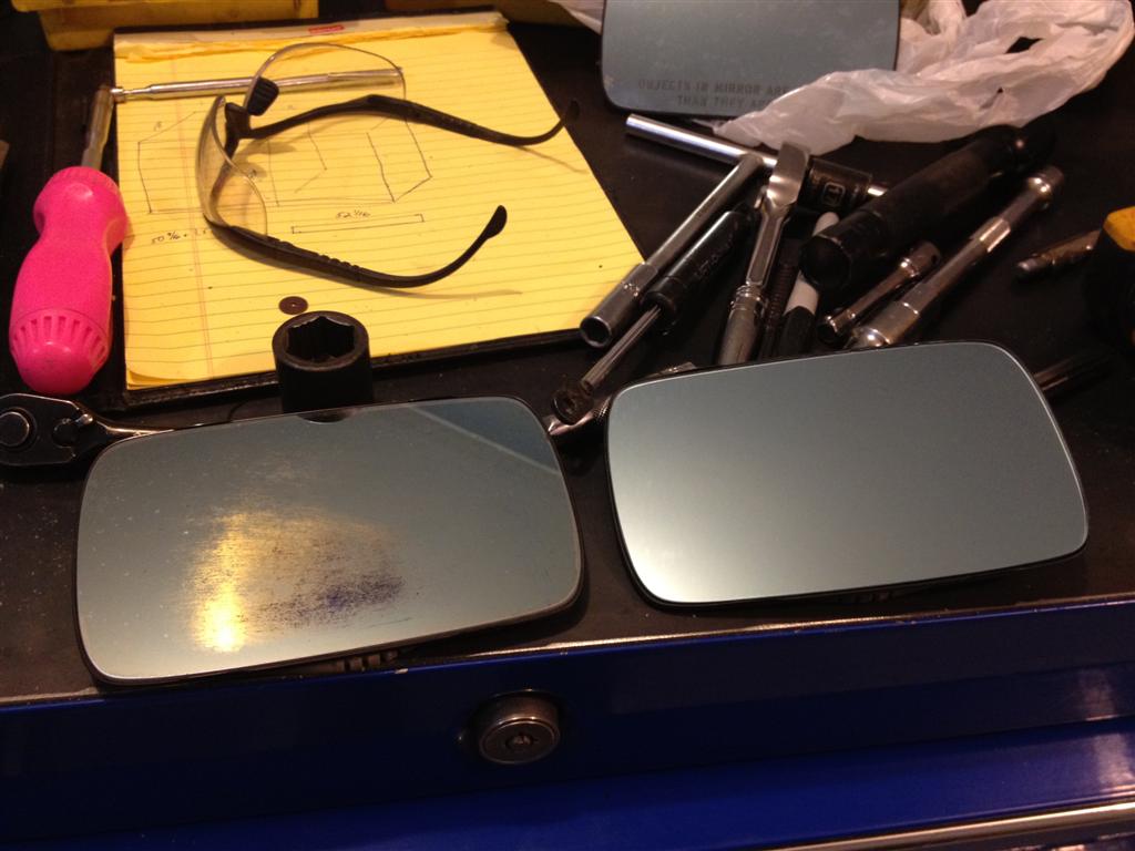

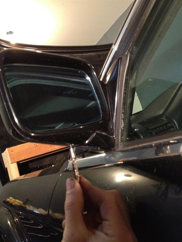

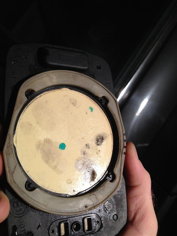

I got a little too ambitious trying to clean up my driver side mirror one day and took off some of the tint/glaze? You can see old vs new to me
Conveniently the mirror glass has a ring that locks it to the motor assembly of the mirror.
You just stick a screw driver in, rotate counter clockwise and out she comes.

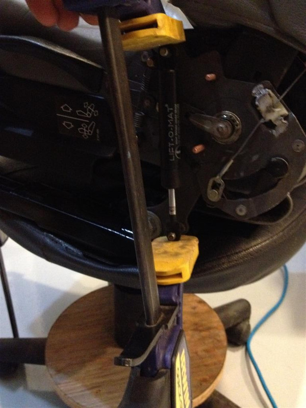

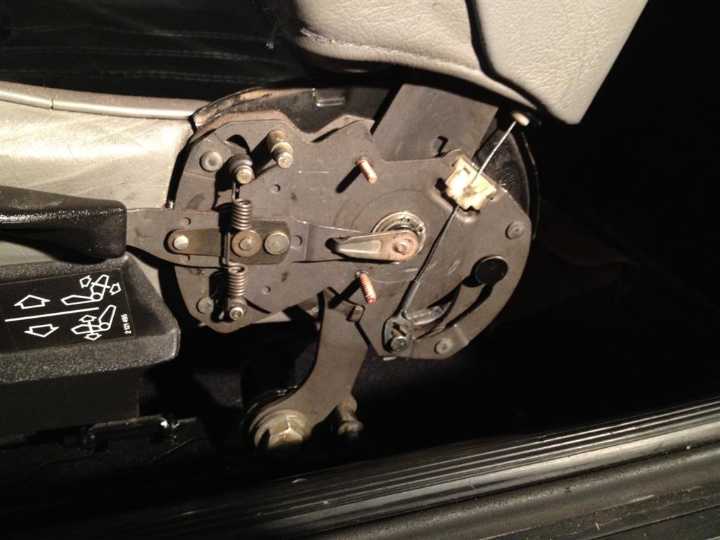

My driver side seat was missing one of the raise lower shocks.
Having scrounged one of these I needed to remove the seat to give myself room to install the replacement

Re: German AWD
Lift-o-Mat :)

MT-Getto wrote:Lift-o-Mat :)
Yeah, I guess "Mat" is German for "butt". :laughing:

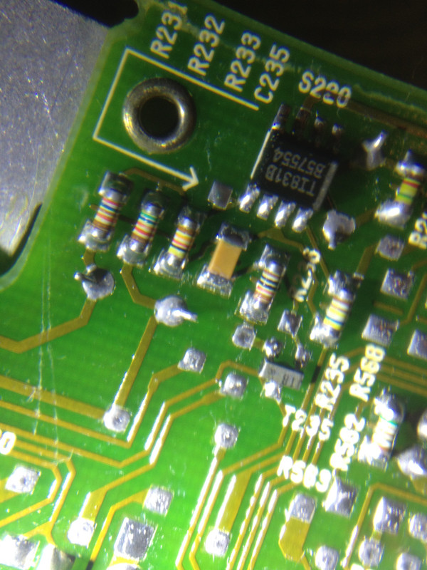

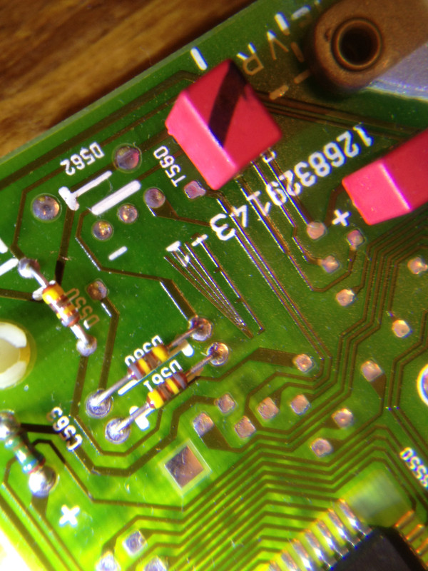

Tonight, despite what I thought, upon inspection I found that my car has an older 153 DME. While I'm not 100% sure yet that I'll put in the 173, I think that I will, mostly because I don't think there would be a later version of the same thing if the old one was just fine. This may be a simple case of Americans will buy it if the number is bigger than previous model, but I can't find much on the internet to support the notion that the 173 is no better than the 153.

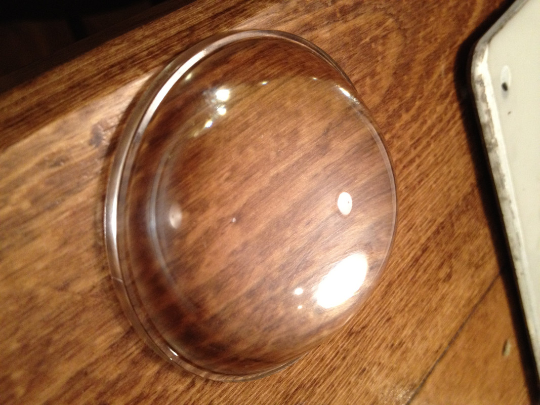

So I thought I'd give the circuit one more real careful inspection.
These glass lenses from projector head lights work great for this.
Holding a flashlight, the lens and my phone all together really doesn't do it justice, but it's certainly a more magnified, clearer and wider field of vision than standard jewelers glasses. (Now i just need to get another projector glass so I can make some ultra heavy duty inspection goggles) :nod:
Everything looks good. So, in she goes... well maybe not. I'm on the fence of "go for it" vs "don't fix it if it aint broke"
