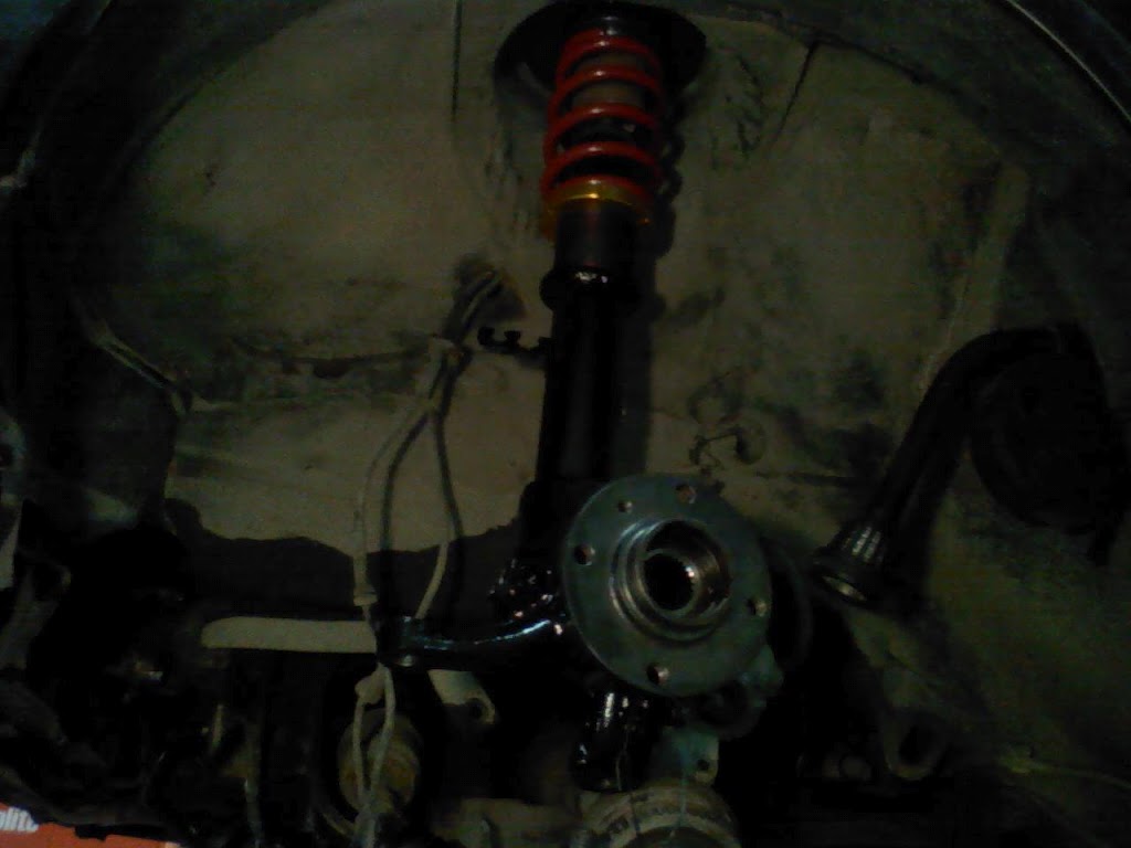

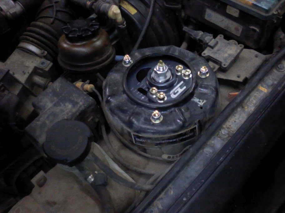

fixed the broken rear spring by doing Ground Control coilover kit 600lb/550lb r/f IIRC, camber plates and top adjust Koni's
front
camber plate

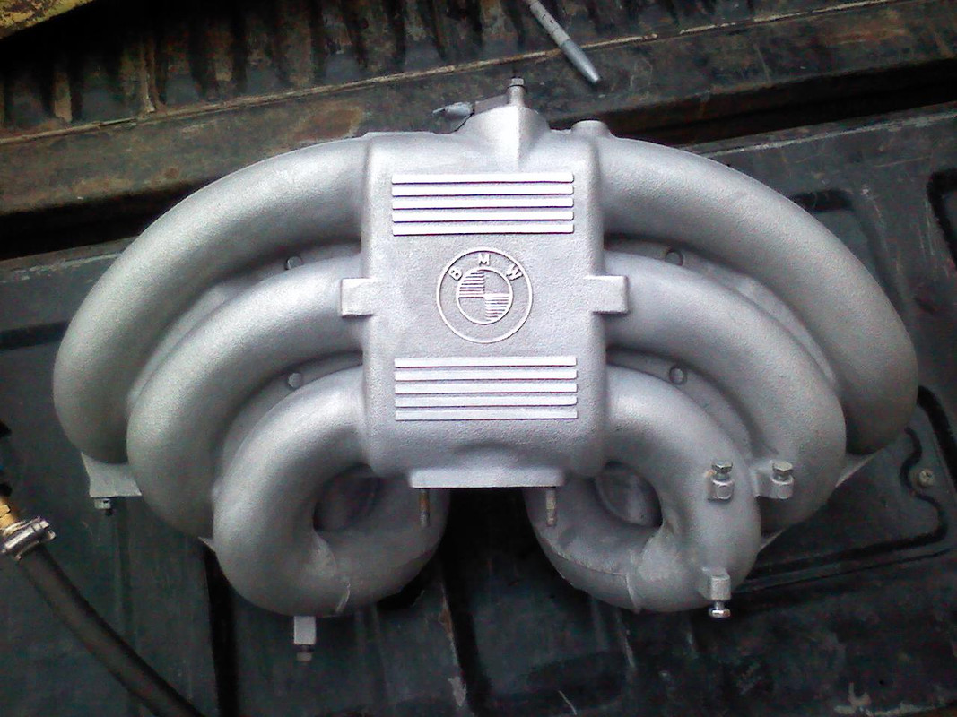

intake cleaned (i know, that's air, but it was in the way of fuel so..)

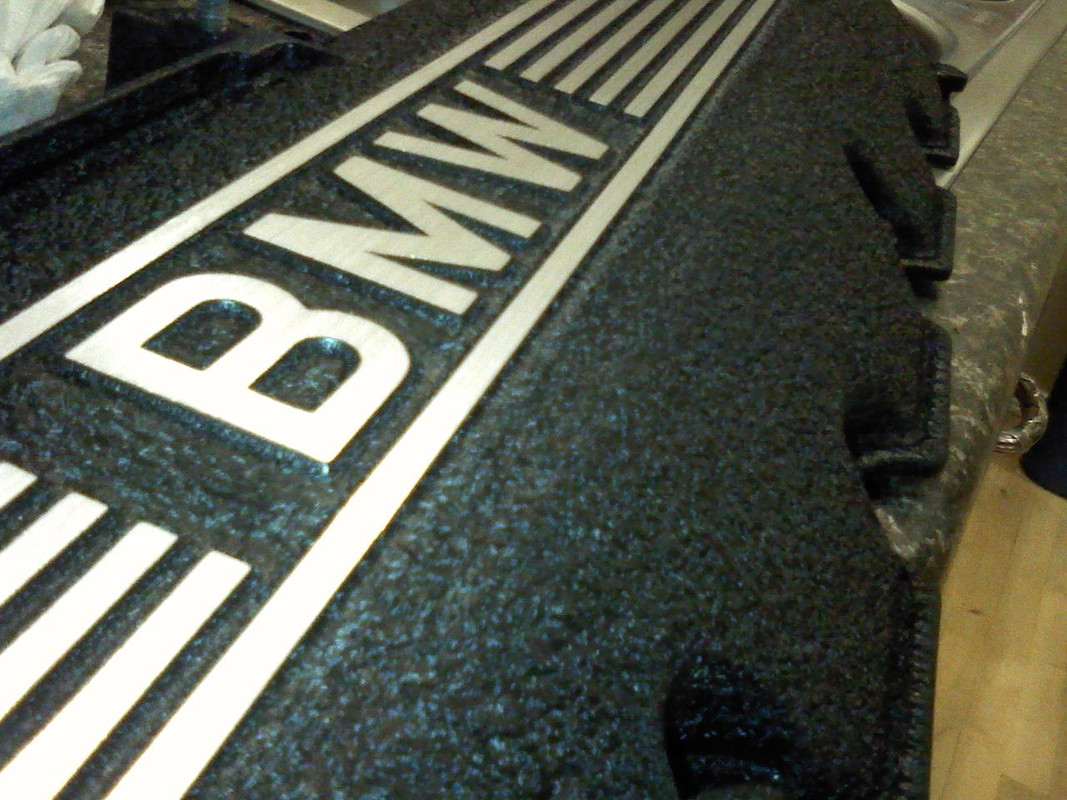

valve cover touched up with some wrinkle paint (same thing... i was there, also did vc gasket)

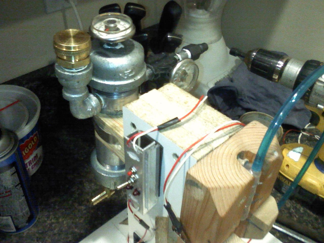

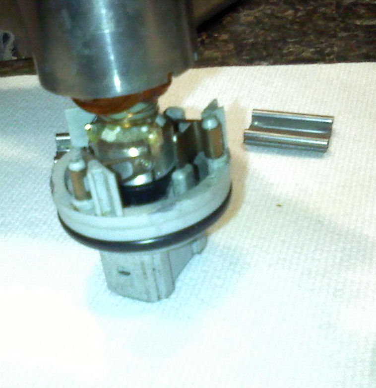

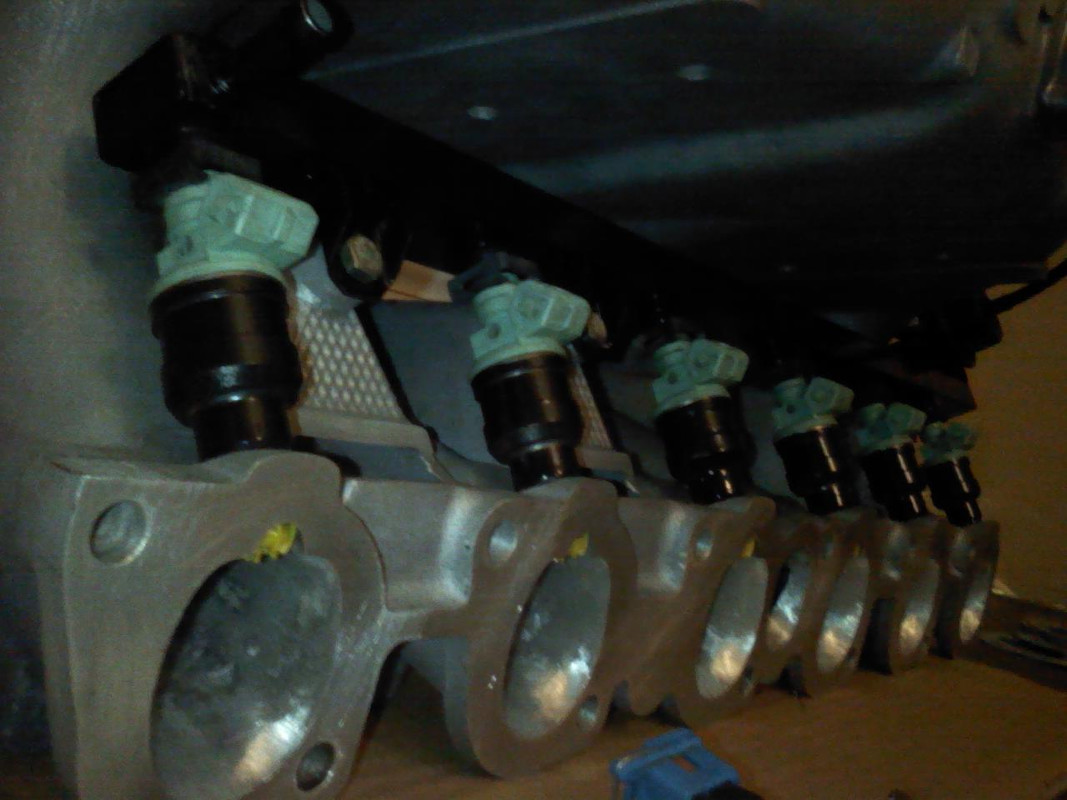

Acquired some 17lb type 3? injectors (4 pintle vs single) from an M50 and cleaned those
installed (this setup positions me well for chipping later)

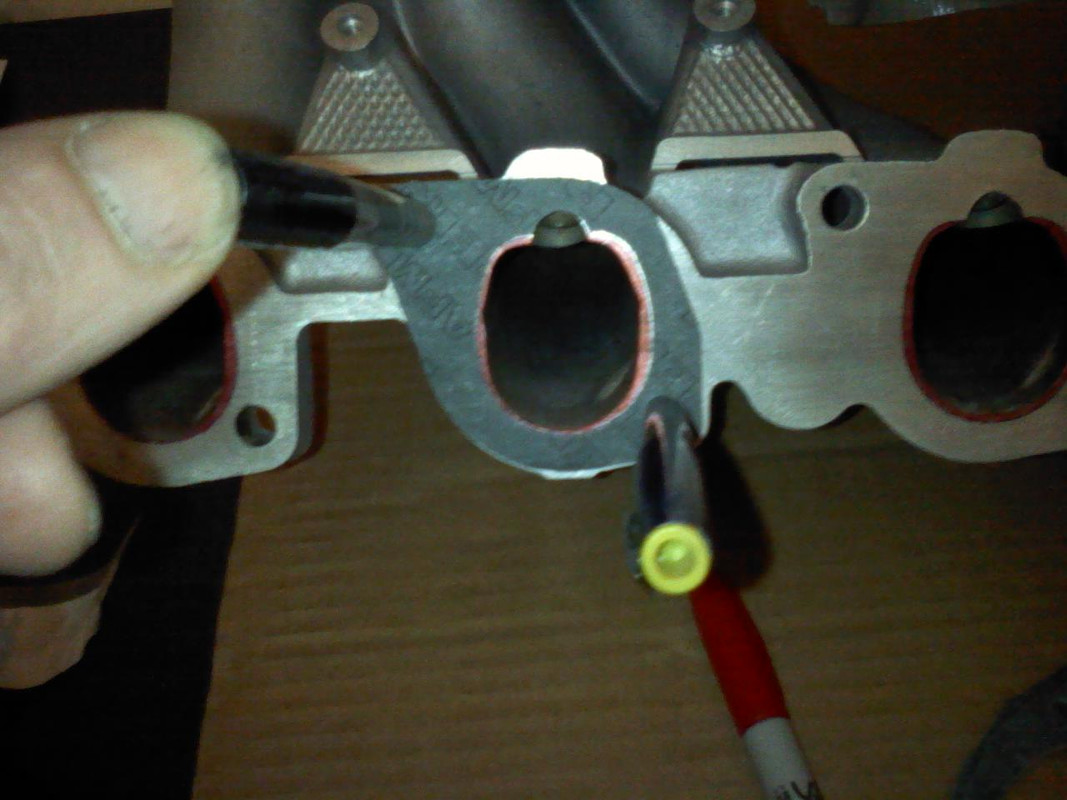

Since I had the intake mani off I could see that the ports didn't line up so...
gasket matched

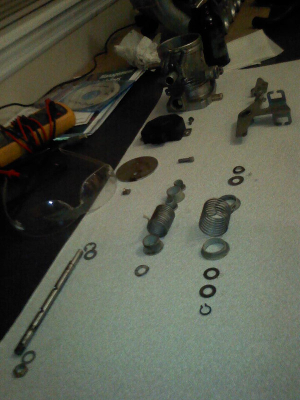

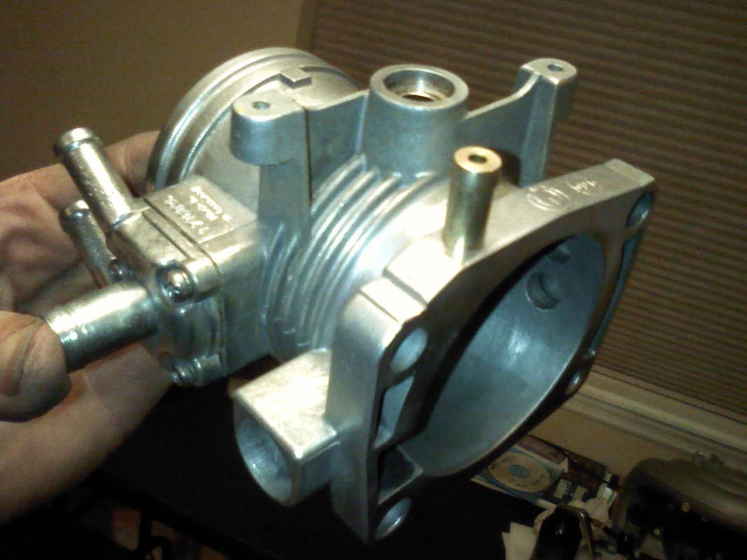

tb stripped
cleaned (i made a baking soda blaster. Note. this makes a huge mess in the garage :p )
What the heck, got some ss allen head and did some hella flush tb plate screws

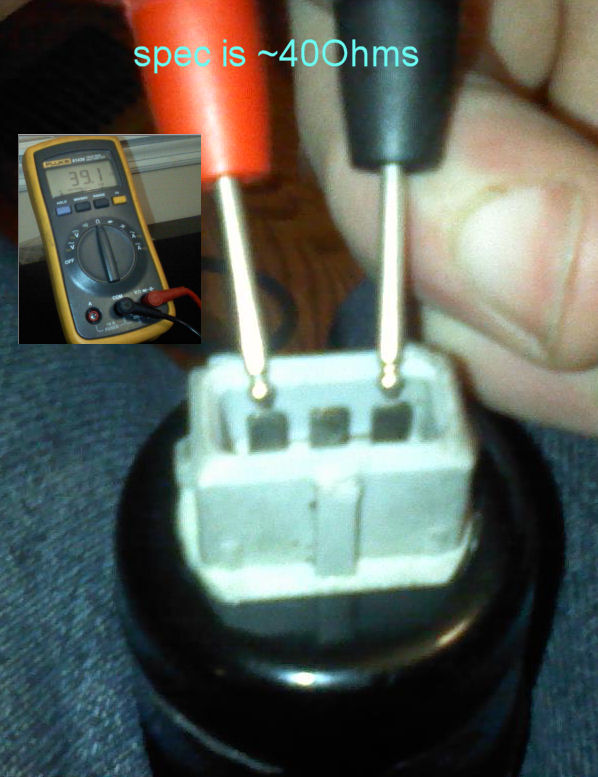

Also cleaned the ICV (idle control valve) and AFM and made sure they were in spec

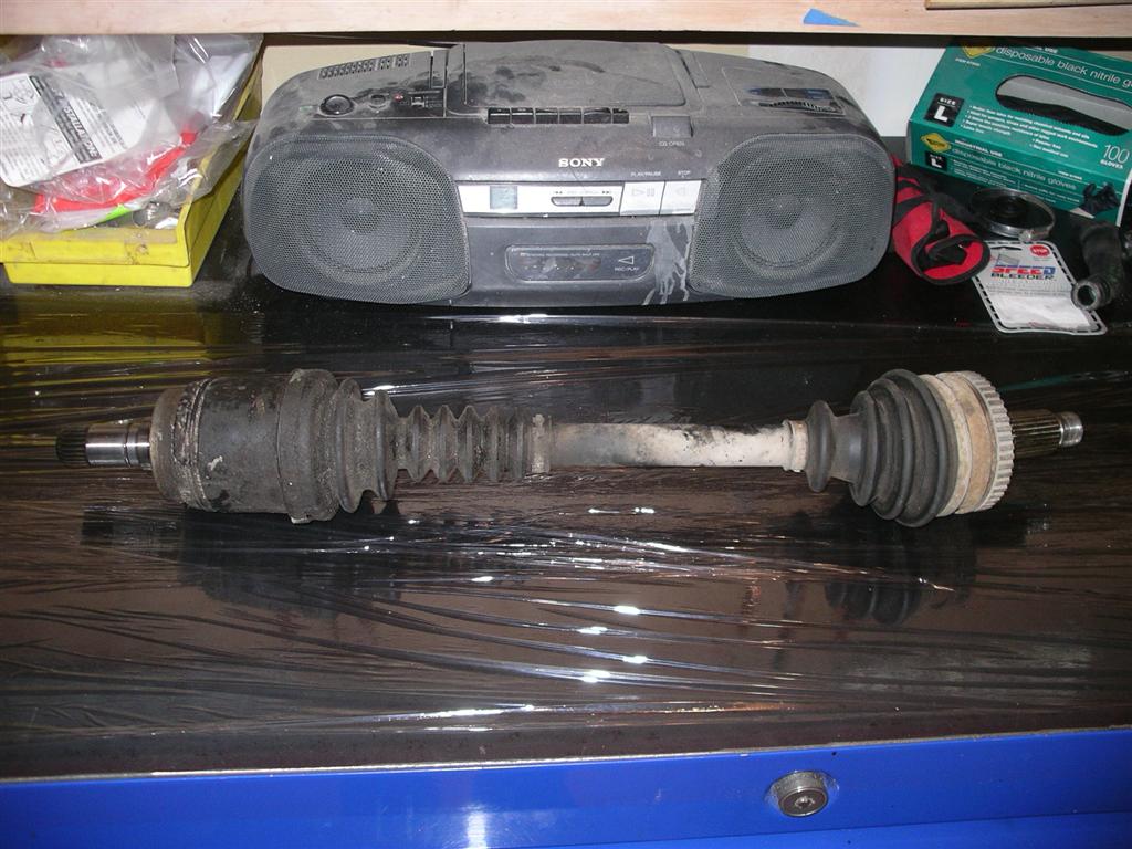

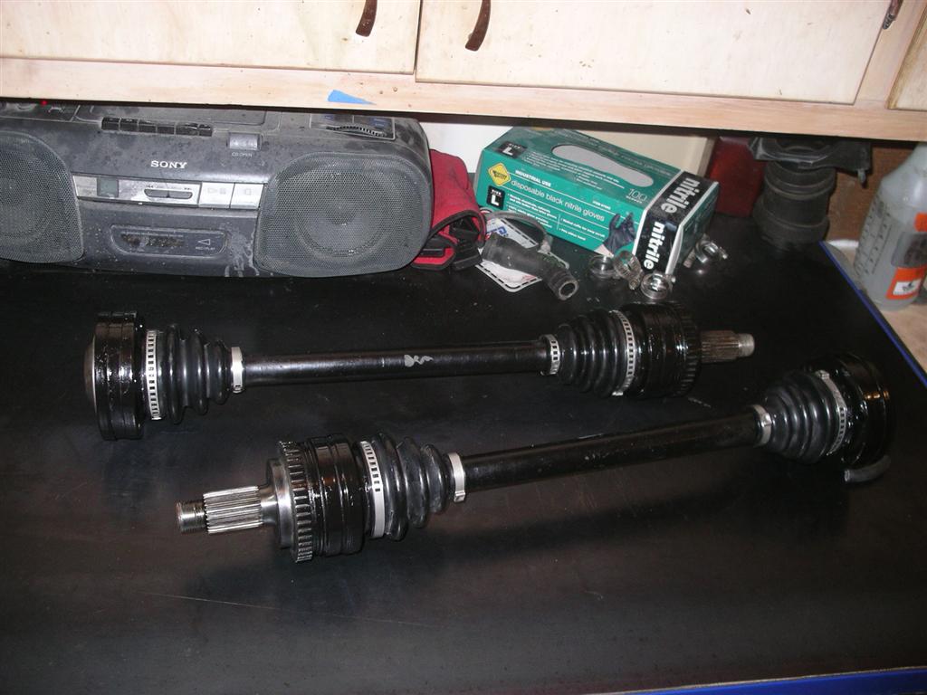

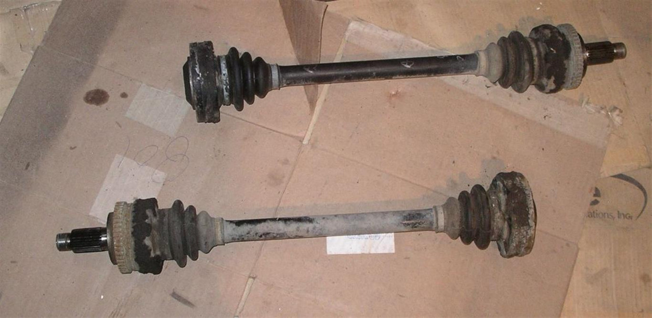

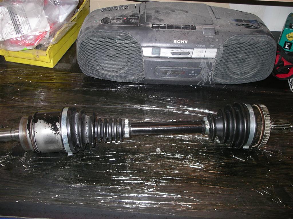

Rebuilt the front CVs. Still tight so just boots and grease
Rebuilt the rear CVs. same thing (nice that the inner and outer boots are same)

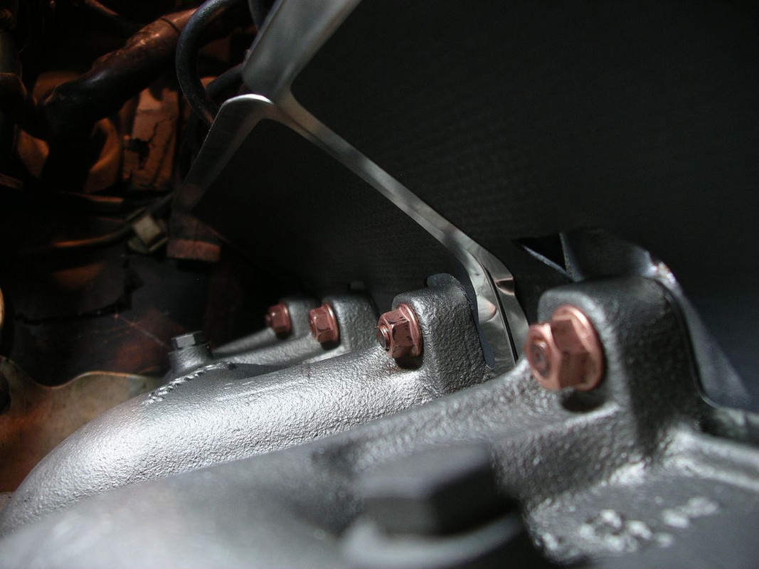

Along in here I didn't like the yucky exhaust side of the motor so put on new exhaust mani gaskets and painted the manifolds with ceramic paint (baked in my oven. Batchler pad :laughing: )

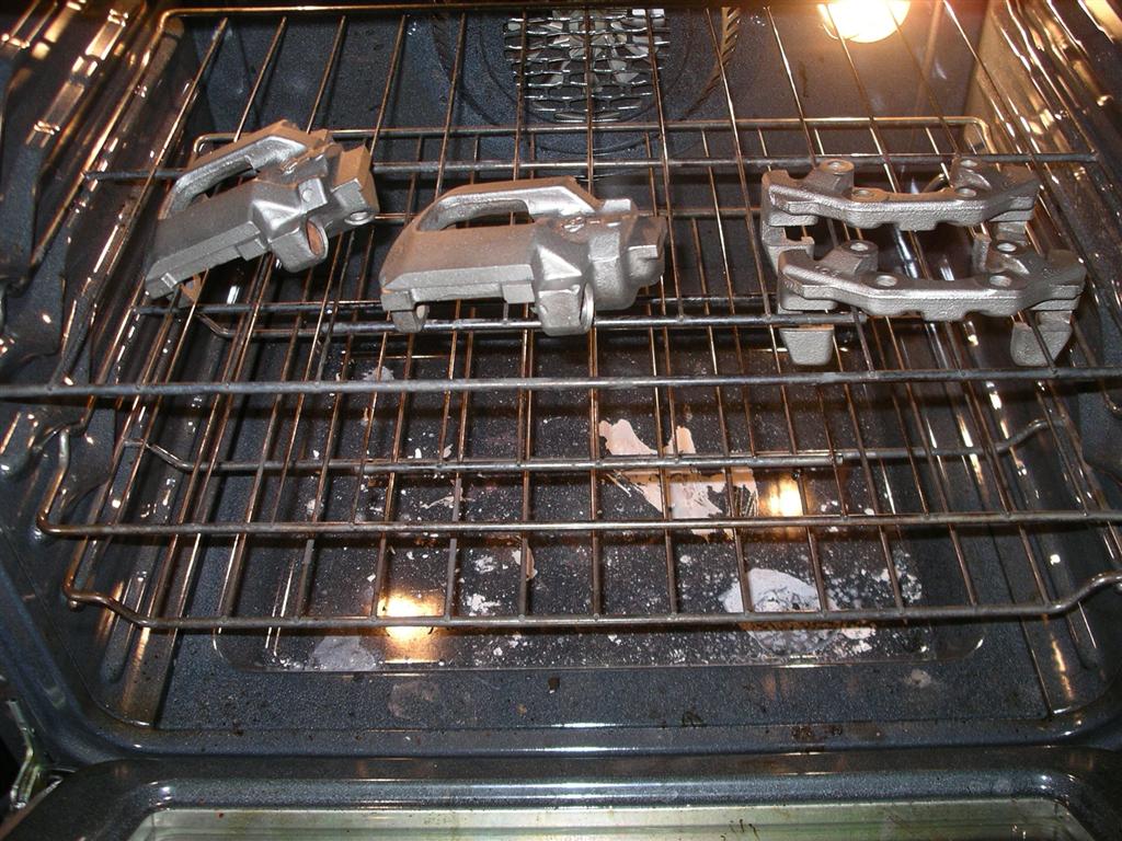

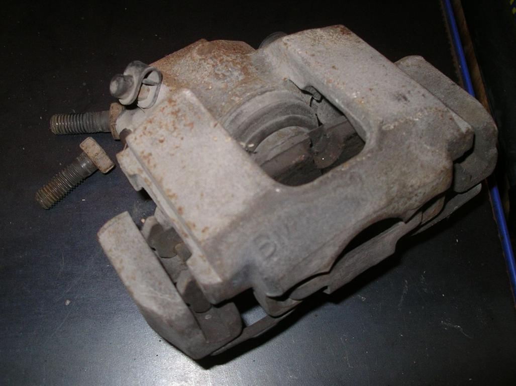

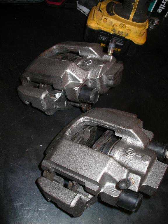

Stripped, cleaned, painted & rebuilt brake calipers
This is where I'm at now. I should be baking the rear calipers tonight and installing SS lines. :beer:

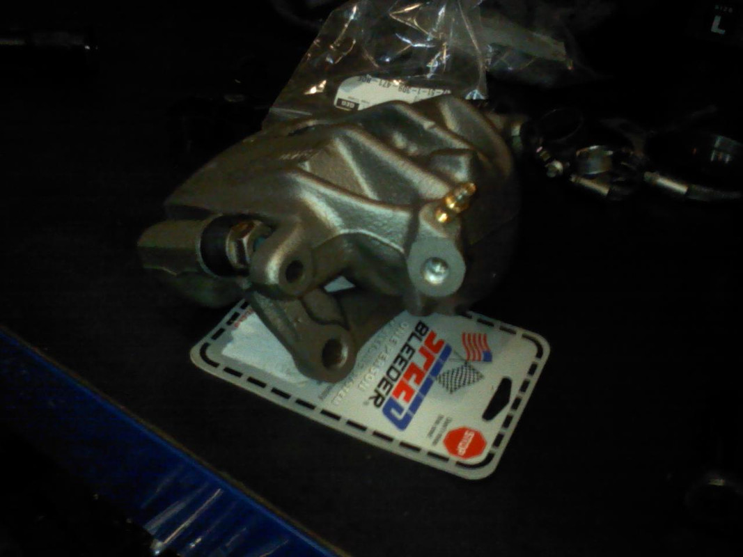

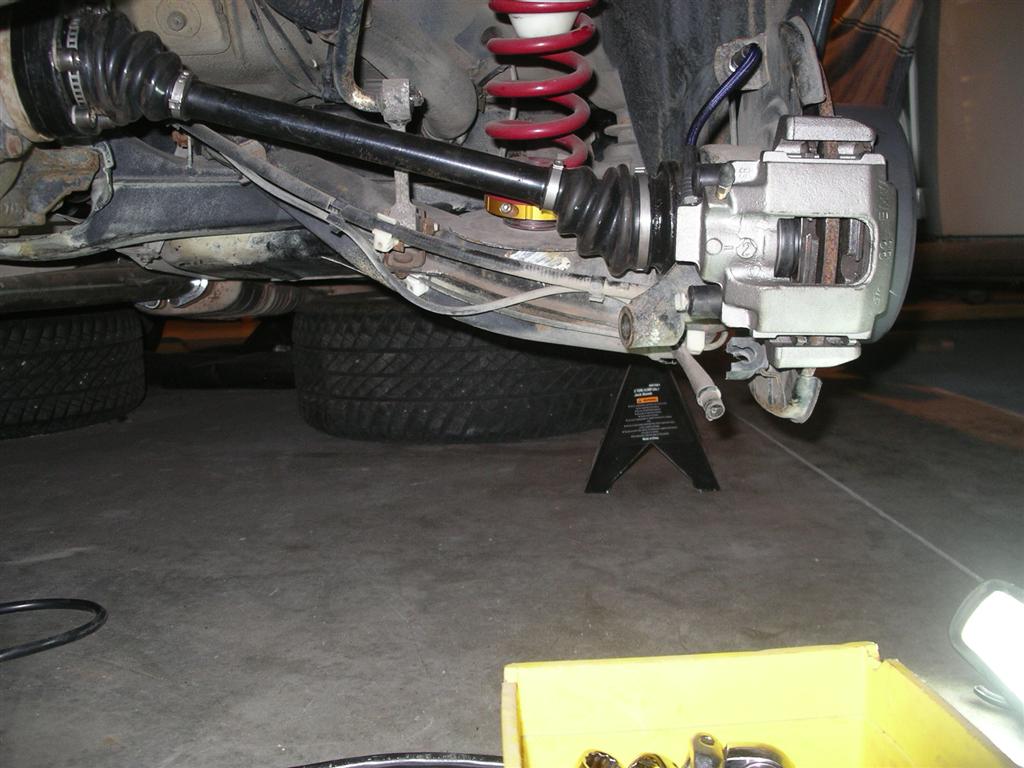

Baked the calipers tonight. Three cycles, 30 min each @ 250, 400 & 600
Installed the new seals and speed bleeders :thumbsup:
Put on the CV axles and calipers. Actually only one. I have a "real" job where I should be mostly awake. :sly:
peace :beer:

Hey! Can you elaborate on the contraption for the injectors?
