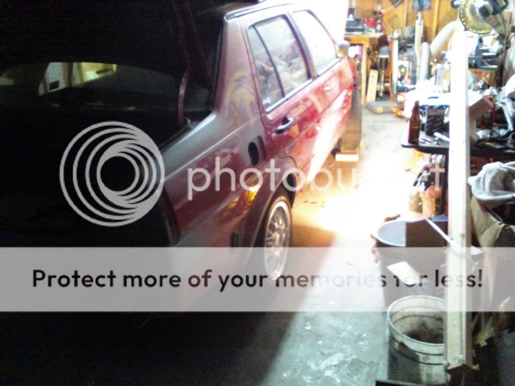

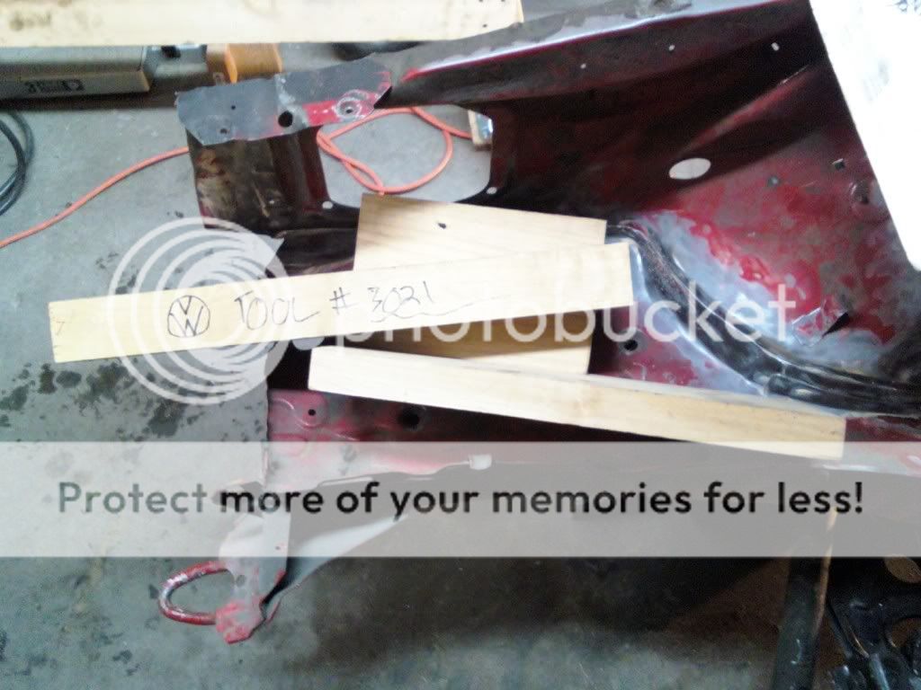

The jetta is back on the ground. Used the old shocks for now, just so i can move it around. Made a tool to position the rear beam pivot. Leveled the beam with some bricks and floor jack then used a protractor, some string, a nut, and gravity to double check i had the angle right.

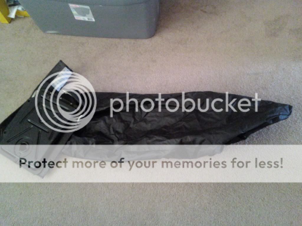

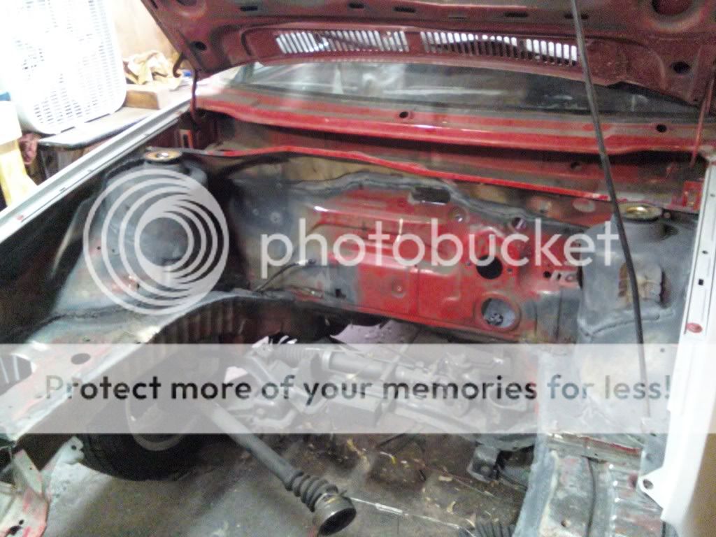

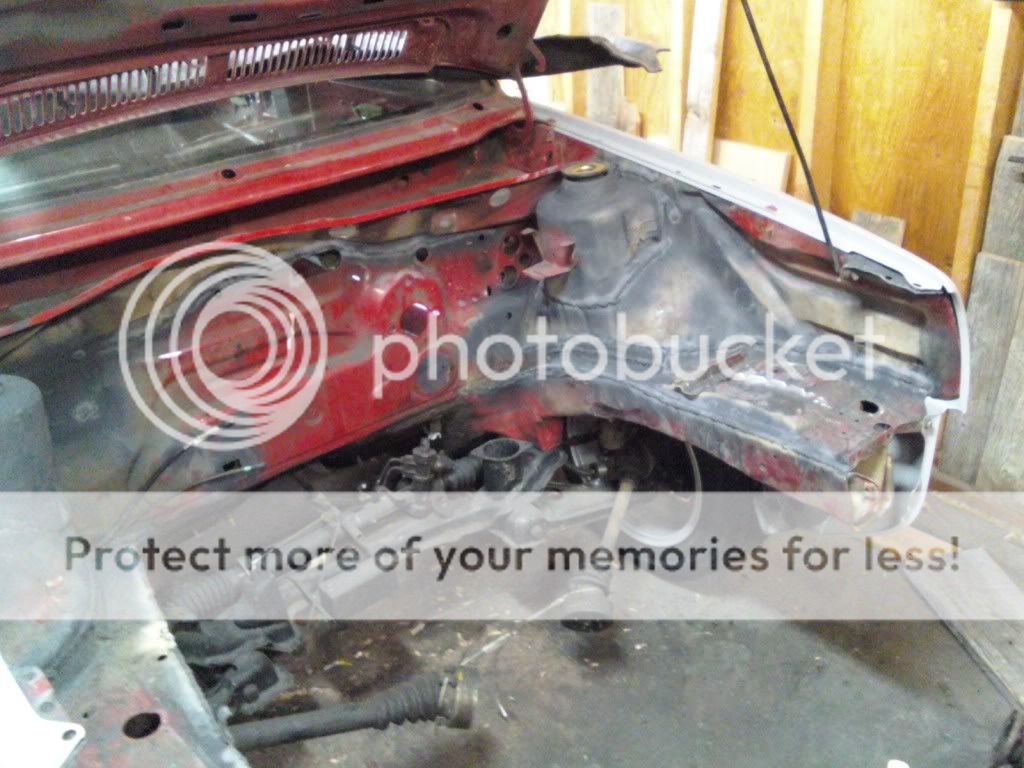

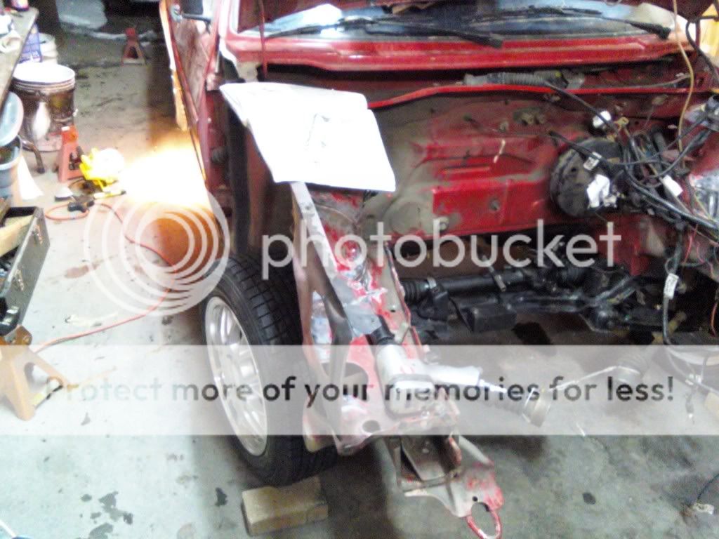

Got back and crackin on the body work. Did all the welding in the bay, filled some holes that i was not going to be using, removed the lips on the frame rails, cut out a rusty part under the battery replaced it, welded up the side trim and spoiler holes. Next grinding and smoothing it all out. Also picked up a ski sock for the back seat. :unibrow:
