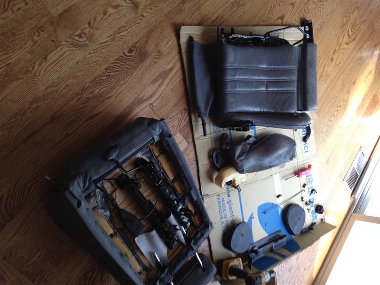

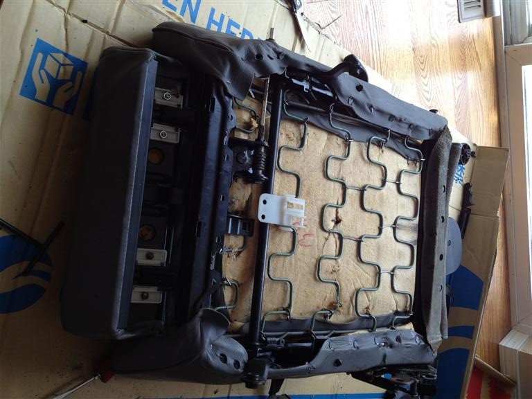

So I started reassembling my seat then noticed that one side pivot for the back rest was loose while the other side felt tight.

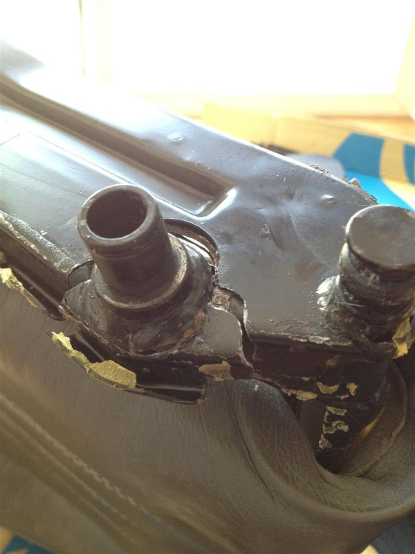

So investigate and found that the pivot is completely broken. I don't know how many times you've got to plop your bum down to break this, it's not thin.
Take a break and have an epic peanut butter, multigrain cheerio & craisin burrito.

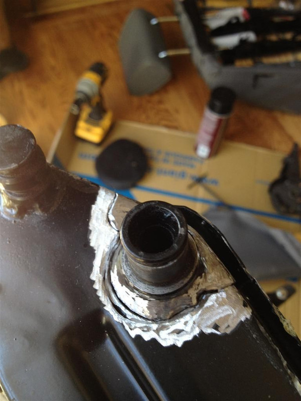

Okay, rev'd up again, sand the joint to prepare for welding. I used my dremel because of all the curves and such

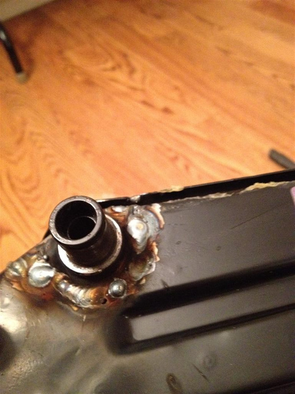

Weld it up, now I'm ready for assembly again

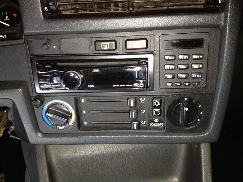

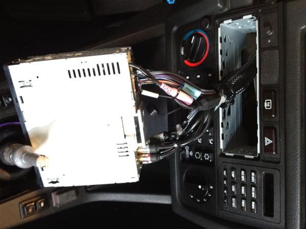

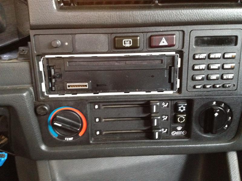

I started putting the dash together and put in the HU.
Put it in the dash, fits good

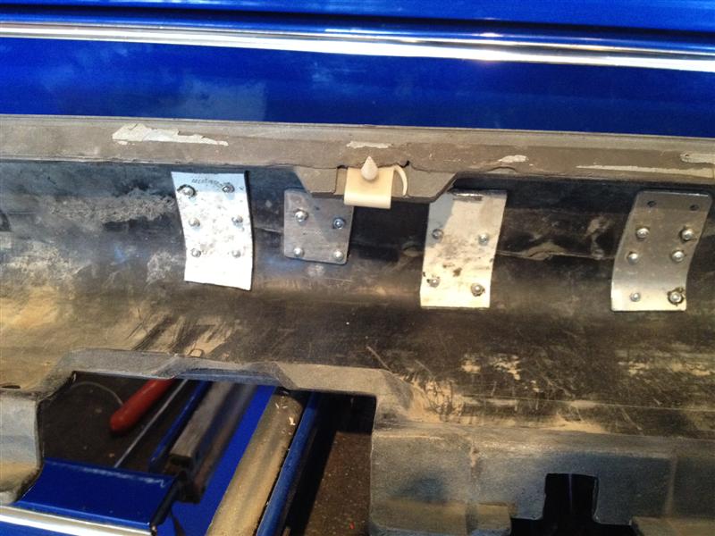

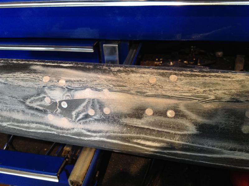

Oh yeah, almost forgot. I worked on my skirt as well.
It was cracked all the way through and not looking so good so first I tried plastic welding it, but that didn't work, something about the plastic more burnt than melted.
So I bent some aluminum, counter sunk drilled the plastic and riveted it back in place. Then some body filler and sanding.
