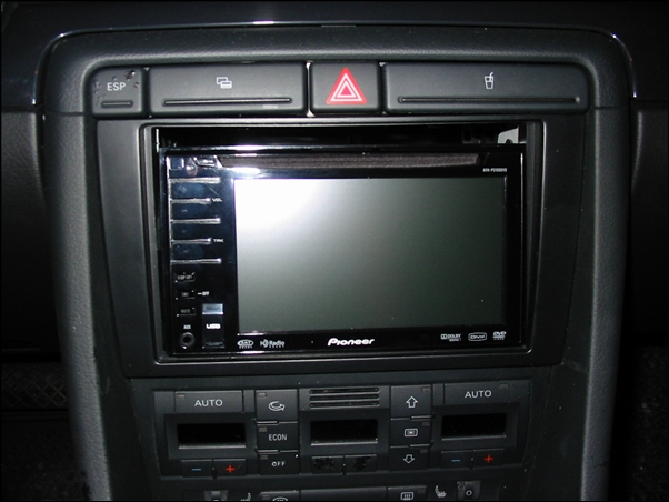

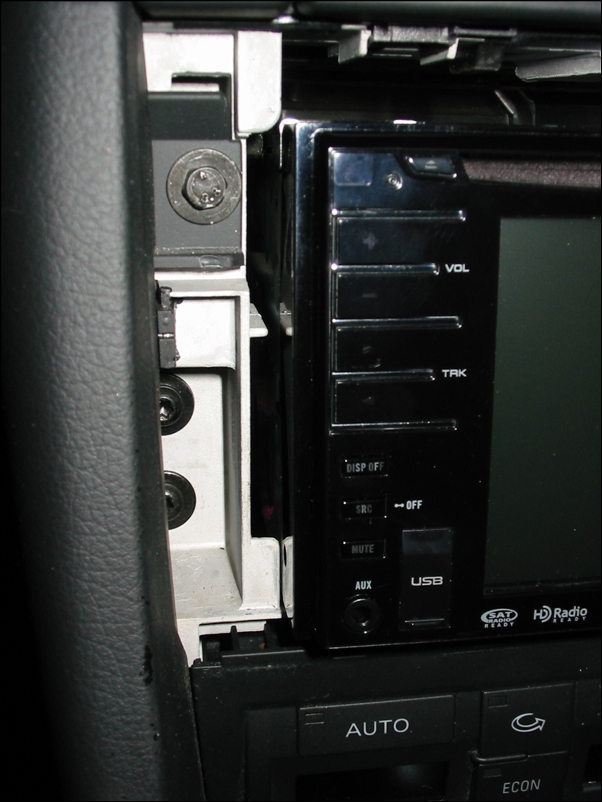

Hey I was going to call but I ll just jack my own thread...I have a question about what mounting hardware to use on that Pioneer - There is a kit that comes with trim ring and hardware to mount but I thought I would get your opinion before. I don't have access to the right tools to make a bracket, and the trim ring that came with the HU sucks balls - it doesn't even look like it should go with that model. Suggestions?

Basically the HU is smaller than the metra dash kit opening, and the trim ring that came with the HU is bigger than the opening of the metra. So there has to be some trim ring to fill the gap between the HU and the inside opening if the metra kit right? I don't see any way to iso mount the HU because its too small, and there is nothing to mount it to. I would totally pick up that kit if I can find it locally...the installers here are fucking retarded and didn't even know about the DD pioneer kit. I do give props to the best buy install bay cause he knew, but didnt have it in stock.

Here are some pictures of what the setup is:
I didn't get a pic with the trim ring, but it sucks and I won't be using it anyway :\ If your supplier will sell me the kit I'll be willing to give it a try, even if it doesn't work. Or if you have a better solution :heart:

I talked to my guy in billings, and he says tha he doesn't have one in stock, but it would take him maybe a day to get it. He might actually be a good guy to talk to on this also. He is a factory trained Pioneer tech, so he may be able to shed some light on it, since he can see and touch everything. It looks to me like you may need that kit, and then you would have to do some modification to the trim ring to get it to flush into the metra bezel. That is what it looks like from over here. If you want, I can get him to send up the DD kit, and I will put you in touch with him.
