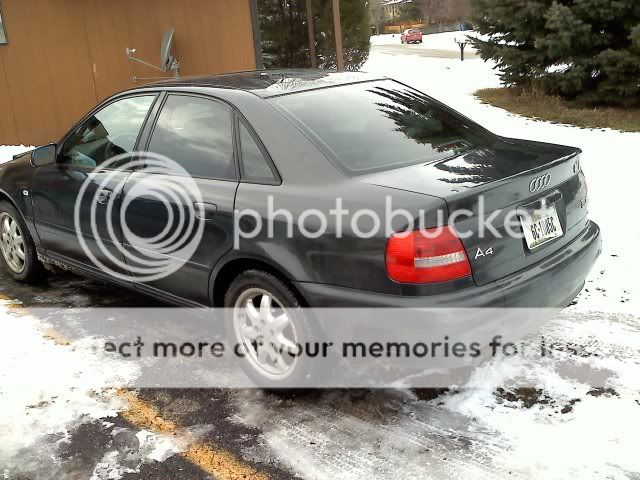

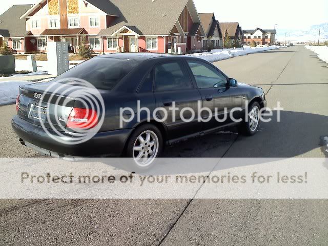

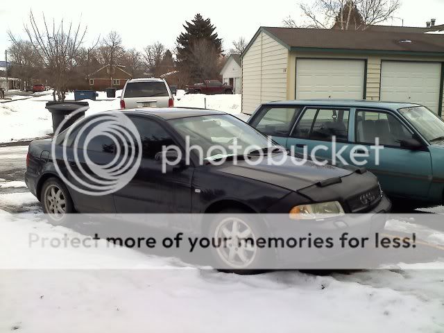

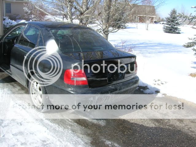

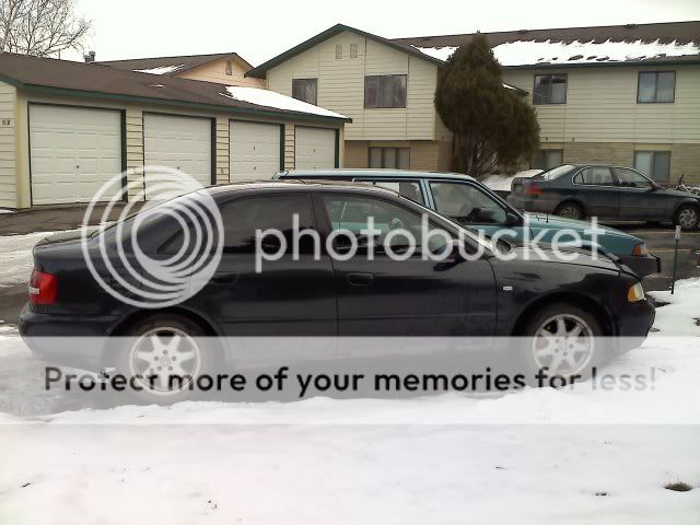

It a 99 1.8T Quattro Manual with around 70k on the clock. Volcano Black Micah paint. Like i said, it had its issues, so i was able to pick it up for 3600. Here are some pictures from before/ right when i bought the car.

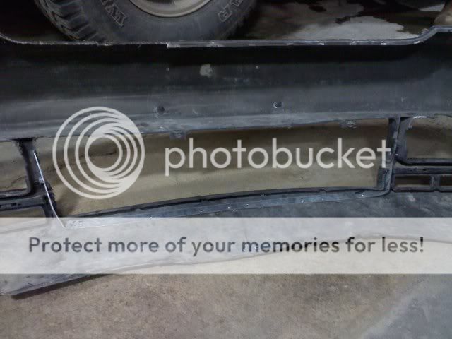

Tore the front end apart a bit to asses the damage. Most of the tabs on the bumper are torn, and the PO just globbed glue on everything. Its pretty nasty. On the plus side, its still solid enough to use, and since its already beat up i can hack it up some more without feeling bad. Not a huge fan of the way the stock front looks, but i cant afford an s4, or aftermarket right now. I decided to just cut the bottom of the bumper/top of the lower valence, as well as removing the factory bumper grilles. Also shaving the headlight washer holes. I think it looks better, and makes room for a FMIC later on.
Last night i spent most of my night just roughing everything out. Added some steel to support the bottom of the front valence, cut out a bunch of mounting tabs, and did a whole lot of plastic welding

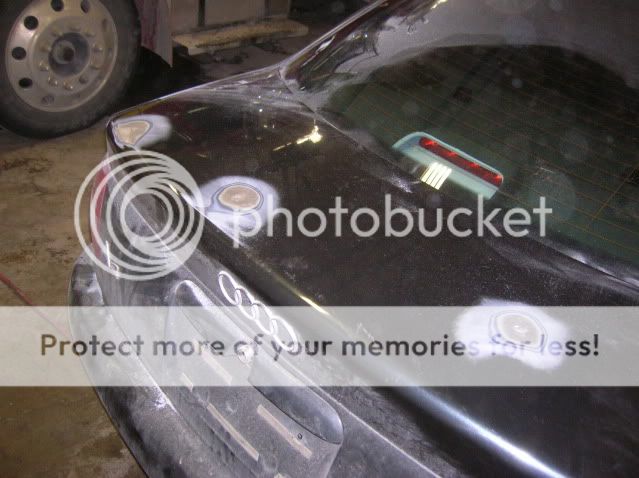

Did some bodywork this weekend. We had a crazy hailstorm last summer, so i had three dents on the trunk lid and one on the left sail panel. Theres also one on the right front fender, but i decided to leave that for another weekend. I thought id document the way i fixed these, as i used tools that most everybody has access to. I was able to use a nice miller mig welder, but other than that, pretty standard.
So first step, unhook the battery. Ive seen some people weld on a car without damaging anything, but ive also seen people fry computers and modules by leaving the battery connected.
Next is to remove the paint from just the dent. The goal is to keep the repair as small as possible, so dont take a ton off yet.

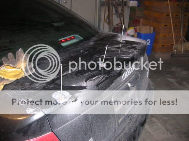

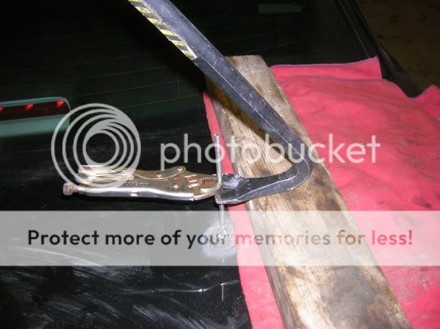

Heres how i pulled the dent. Normally, a special gun is used to weld small pins to the dent, and a slide hammer is used to pull the dent up. I had neither. No problem.
I cut four pieces of 1/8 inch steel rod, and clamped a vice grip to the top. Put the ground clamp on the vise grip, and then put two tack welds on either side of the rod. Behold the porcupine.
To pull the dent up, i clamped a vice grip to the rod again, and used a pry bar against a block of wood to pull upwards...The goal isnt to just lever up hard enough to pull the dent out, as the surrounding metal will be pulled up as well. Tapping all around the dent while pulling gets the steel molecules moving enough that just a bit of upward pressure is enough to put the steel in the right spot.

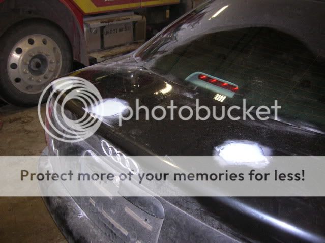

Body filler works best if its under 1/4 inch, so once the dents most of the way out, the rod gets cut off and the weld ground away, Keep the heat down to avoid warping the steel. I used a DA sander to feather the repair out a bit more. I usually go to around an inch outside the damage.

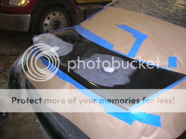

Some filler.
Ill shape the filler with 80 grit, leaving it a little bit high, then finish up with 180 grit to get ready for the filler primer. I used to use the rattle can stuff, but a quality urethane primer is soooo much nicer to work with.
I did some more work on the front bumper too, and got it in primer too. Ill get pictures of that stuff later. Im hoping to have a hood and get some paint laid this weekend, but well see.
