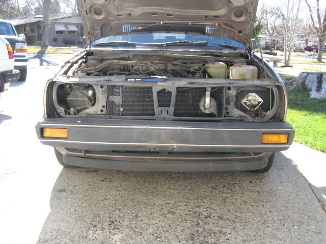

Old Grill and lights
Core support needed some love

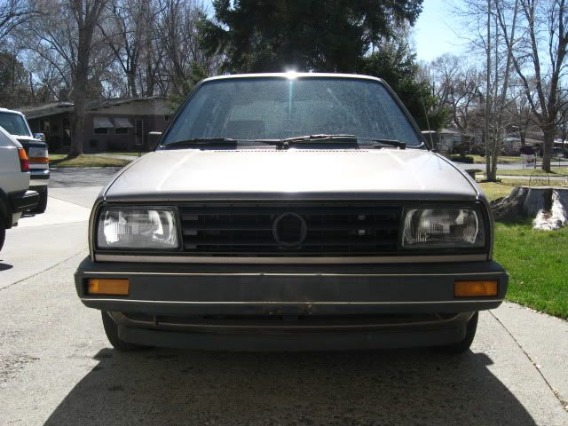

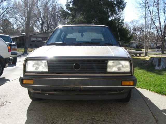

The smoked Ecodes and new grill Installed

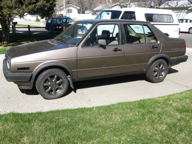

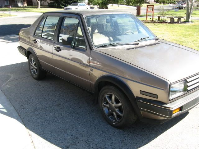

This one has the new and freshly painted wheels on it. You might also notice the joey modded banana light.
Also Mk3 style door handles...she is starting to come around.

The mk3 handles are not a direct swap are they? If not where did you get these? I'm so sick of telling people "pinch don't pull!"
Re: 86 Jetta
They are some Chinese knock offs they are a direct fit but don't expect them to fit too well. You can get them from ebay about 40 bucks for the set.
